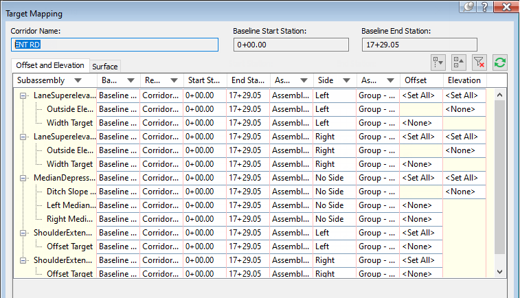

For this example, we click the Targets button for Region (1). This displays the Target Mapping dialog box as shown in figure 33. Note the objects that are referenced as targets.
Figure 33: Target references feature lines
You can add as many targets as needed for any given target point, and Autodesk Civil 3D will simply tie to the one that it encounters first. In this case, the target is set to a feature line named Site2 Perimeter. This feature line is controlling the horizontal and vertical location of the points that are tied to from behind a curb.
