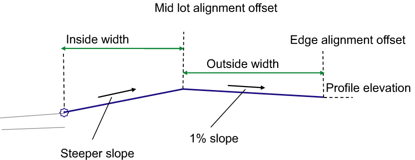

This subassembly is used to grade lots from a right of way line.
The following illustration shows an example of this subassembly being used when the target profile elevation at the back of the lot is higher than the attachment point.
The following illustration shows an example of this subassembly being used when the attachment point is higher than the target profile elevation at the back of the lot.

Behavior
The lot grade assembly tool needs to start at the right of way and, much like the BasicLaneTransition subassembly, it will hold grade and change offset to the middle of the lot at a default slope of 1%. The value of the slope can be input by the user. At the middle of the lot will be an alignment with no profile. So the assembly will be a link from right of way to that mid lot alignment at 1% slope. Then the mid lot alignment will link to the back of lot, which is a fixed elevation; for example, 74.00 feet. We need to maintain a minimum slope of 1% on the back half of the lot as well. Therefore there needs to be a rule in place if the front of the lot grade at 1% slope does not allow for a minimum slope of 1% for the back half of the lot, then the back half of the lot grade needs to change to 1% and the front half lot grade needs to go steeper.
Layout Mode Operation
In layout mode, this subassembly draws the lane using the input parameter values. It will use 1% as the steeper slope value.
