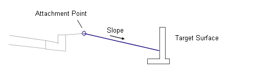

This subassembly is a general purpose utility to extend a link from the attachment point at a given slope to the closest intersection with a target surface.
The attachment point is at the beginning of the link.
Input Parameters
Note: All dimensions are in meters or feet unless otherwise noted. All slopes are in run-over-rise form (for example, 4 : 1) unless indicated as a percent slope with a “%” sign.

Behavior
A link is extended to the left or right from the attachment point at the given slope until it intersects the target surface.
By default, a cut or fill link will be added from the attachment point to the target surface. If the link needs to be added only in cut or fill conditions, specify appropriately a value for the Add Link In property of the subassembly. If the cut link and fill links must be at different slopes, then add this subassembly twice, at the same attachment point, once for Cut Only and then again for Fill Only conditions, with slopes as needed.
This subassembly includes an optional input parameter named Use Superelevation Slope that lets you specify to use the superelevation slope for the shoulder. This parameter can be set to a) Outside shoulder slope, b) Inside shoulder slope, c)Outside Lane Slope, d)Inside Lane Slope, or e) None. None is the default setting.
