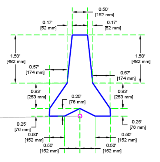

The ClarkCountyConcreteBarrierType2 subassembly inserts links to represent a Clark County Type 2 concrete barrier.
You should verify that the dimensions used match your interpretation of the standard plan.
The attachment point is at the bottom center of the concrete barrier.

The subassembly constructs the shape of a Clark County Concrete Barrier, Type 2, with the base centered about the attachment point.

P7-P8 JB_Top Top of the barrier
L3-L9 Barrier Barrier links
S1 Barrier Shape of the barrier
