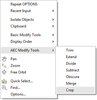

Edit your input data to include only the essential regions.
Before you add contour polyline data to a surface, consider whether it includes any terrain that is not needed for design purposes. If so, you can use the AEC modify tools to crop unwanted portions of the contours. As shown in figure 5, these tools are available on the right-click menu when no objects are selected in the drawing.
Figure 5: Location of AEC modify tools
