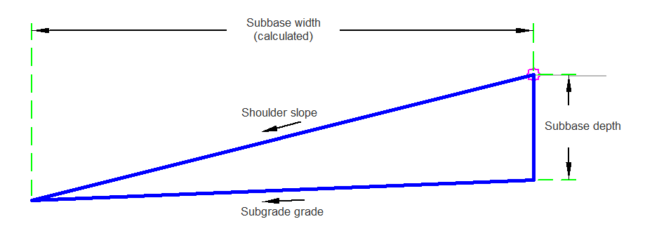

The ShoulderIntersectLeft subassembly creates a shoulder extended to a daylight point based on the shoulder slope and subgrade grade. It only operates to the left.
The attachment point is at the inside edge of the left paved shoulder, which is typically at the outside edge-of-traveled way on the left side of the baseline.

Depth Depth of the shoulder below the attach point. Numeric, positive
1.5 ft
0.45 m
Subgrade Grade % slope of the subgrade. Numeric -4 ( % )
Shoulder Slope Slope of the shoulder. Numeric, positive 4 (: 1)
Material Shape Code A list of codes to be assigned to the material shape. Comma-separated string Subbase
Superelevation Specifies to use superelevation slope. Selection list LeftOutsideShoulder

The shoulder is inserted for the given shoulder depth, shoulder slope, and shoulder subgrade. The width is calculated where the shoulder slope and shoulder subgrade intersects. Then the points, links, and shapes are calculated.
Layout Mode Operation
In layout mode the subassembly displays the links comprising the shoulder.
