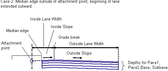

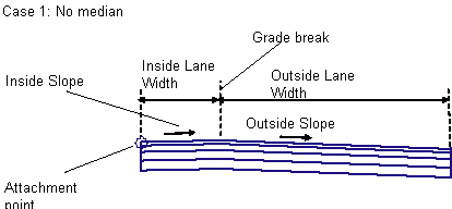

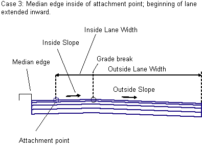

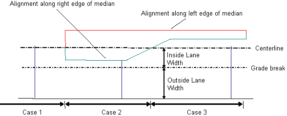

The alignment defining the edge of the median may at times be either not present (Case 1), outside the roadway centerline (Case 2), or inside the centerline (Case 3).
To use this subassembly, you should have separate alignments defining the left and right edges of the median. It may be necessary to define separate corridor model regions for each individual median. This subassembly differs from LaneFromTaperedMedian1 in that it provides for a grade break with different slopes in the travel lanes.

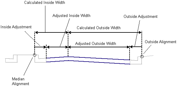

Inside Adjustment |
Used if the Median Edge alignment is at a fixed offset from the actual edge-of-traveled-way (for example, at the back of curb). Adjusts the calculated Inside Lane Width to account for the offset (see diagram). |
Numeric, positive |
0.0 |
Outside Adjustment |
Used if the Outside Lane Width alignment is at a fixed offset from the actual edge-of-traveled-way (for example, at the back of curb). Adjusts the calculated Outside Lane Width to account for the offset (see diagram). |
Numeric, positive |
0.0 |

Grade Break: The width from the attachment point outwards to the grade break between the inside and outside lanes can be defined by a fixed numeric width, or an alignment can be used to override the width. The elevation at the grade break is determined by applying the specified slope for the inside lane across the width of the lane.
Outside Edge-of-Traveled-Way: The width to the outside edge-of-traveled-way can be defined by a fixed numeric width, or an alignment can be used to override the width. The elevation is determined by applying the specified slope for the width of the lane, unless an Outside Elevation profile is given. In that case, the outside edge elevation is tied to the profile, and the slope is adjusted.
Inside Edge-of-Traveled-Way: The location of the inside edge-of-traveled-way is calculated based on the three cases shown in the previous diagram. If a Median Edge alignment is given, and that alignment is outside of the lane’s attachment point, the inside edge is shifted outward from the attachment point at the lane slope (Case 2). If the Median Edge alignment is inside of the lane’s attachment point, the inside edge is shifted inward from the attachment point at the inside lane slope (Case 3). If no Median Edge alignment is given, or the given one is not found at a station, the inside edge is held at the attachment point (Case 1).
Inside and Outside Adjustments: The Inside Adjustment and Outside Adjustment parameters are provided in case the alignments used for the inside or outside edges are at a fixed offset from the actual edge-of-traveled-way. For example, the alignment being used for the Median Edge may be at the back-of-curb instead of at the pavement edge. In this case, the Inside Adjustment parameter should be set to the width of the curb.

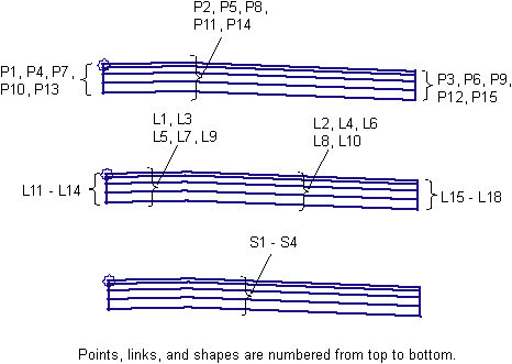

Point, Link, and Shape Codes
The following table lists the point, link, and shape codes for this subassembly that have codes assigned to them. Point, link, or shape codes for this subassembly that do not have codes assigned are not included in this table.
Point, Link, or Shape |
Code |
Description |
P1, P3 |
ETW |
Edges of lane on finish grade |
P4, P6 |
ETW_Pave1 |
Edges of lane on Pave1 layer |
P7, P9 |
ETW_Pave2 |
Edges of lane on Pave2 layer |
P10, P12 |
ETW_Base |
Edges of lane on Base layer |
P13, P15 |
ETW _Sub |
Edges of lane on Subbase layer |
P2 |
Crown |
Crown (grade break) on finish grade |
P5 |
Crown_Pave1 |
Crown (grade break) on Pave1 |
P8 |
Crown_Pave2 |
Crown (grade break) on Pave2 |
P11 |
Crown_Base |
Crown (grade break) on Base |
P14 |
Crown_Subbase |
Crown (grade break) on Subbase |
L1, L2 |
Top, Pave |
Finish grade surface |
L3, L4 |
Pave1 |
Pave1 surface |
L5, L6 |
Pave2 |
Pave2 surface |
L7, L8 |
Base |
Base surface |
L9, L10 |
SubBase, Datum |
Subbase surface |
S1 |
Pave1 |
Area between finish grade and Pave1 |
S2 |
Pave2 |
Area between Pave1 and Pave2 |
S3 |
Base |
Area between Pave2 and Base |
S4 |
SubBase |
Area between Base and Subbase |
