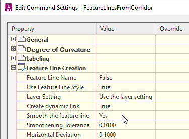

When creating gradings from corridor feature lines, you can use the Corridor command CreateGradingFeatureLine. As shown in figure 4, you can configure the Feature Line Creation Options to smooth the feature line when it is exported, and to create a dynamic link between the corridor and the feature line. Smoothing the feature line replaces tessellated line segments with arcs, and creating a dynamic link ensures that the feature line is updated with any changes to the corridor.
Figure 4: Command setting to smooth corridor feature lines for grading
