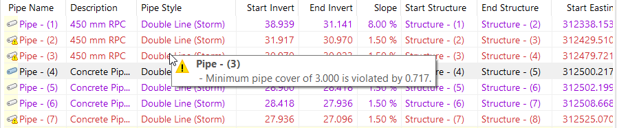

Violations are highlighted to the user in three ways:
  • The icon for the item with the violation includes a small warning symbol in the corner.
  • All data columns for the item with the violation are highlighted (by default) in a bold red font. The style and color of the font for items with the violation can be adjusted by the user from the Project Explorer Preferences panel.
  • When the cursor is hovered over a violated item, a tooltip is displayed which provides detailed information. The user may then choose to address the violation by applying changes to the item either from Project Explorer itself, or from Civil 3D. If such edits cause the violation to be resolved, the violation will be removed from the Project Explorer item.
