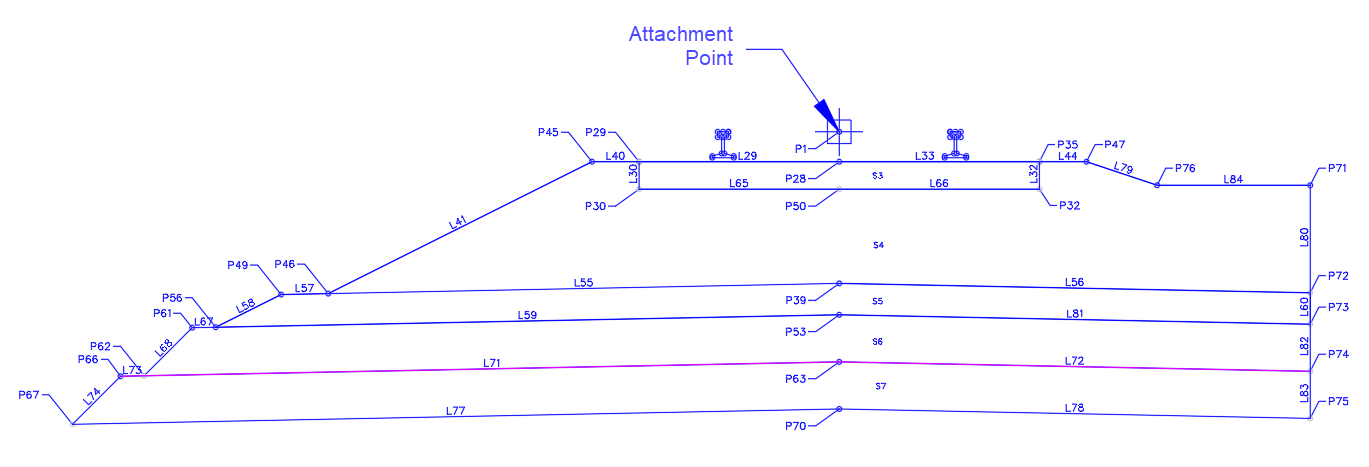

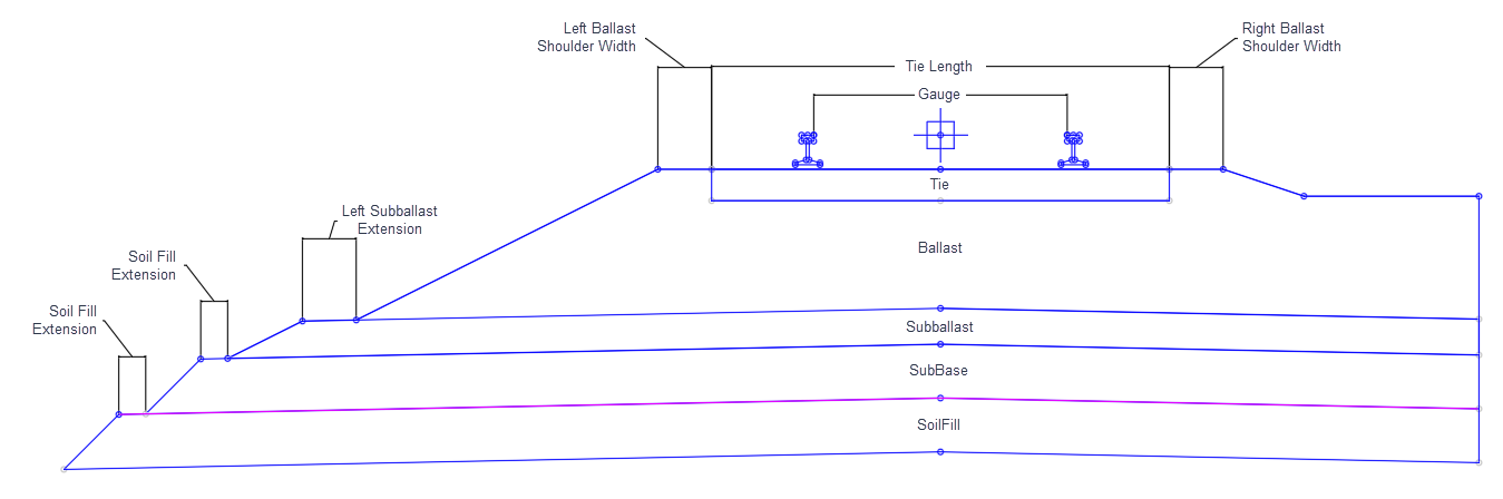

The Left_Hand_Multi_Track subassembly is used for a single railroad that includes sleepers, ballast, subballast, and two additional layers or materials which can be used for Sub Base and Soil Fill material.
The dimensions of the Left_Hand_Multi_Track rails can be edited as well as the dimensions of the material layers.
Note: For this subassembly, the right side elevation should be lower than the top of the ballast. If the right side elevation is higher than the top of ballast, the result will be incorrect. If you need this subassembly to behave differently, you can use the Subassembly Composer to modify the existing PKT file to suit your needs. Subassembly PKT files are located in C:\ProgramData\Autodesk\C3D <version>\enu\Subassemblies\<unit>.
By default, the attachment point is at the centerline between the rails. The track can be moved relative to this point using the subassembly parameters.

Tie Length Length of the tie (also known as sleeper). Numeric, non-negative
8.5'
2.59 m
Tie Depth Depth of tie Numeric, non-negative
7"
178 mm
Minimum Ballast Depth The minimum vertical distance between the bottom of the tie and the top of the subballast. The location of this minimum distance changes at different stages in cant. See Behavior below. Numeric, non-negative 12"
305 mm
Ballast Shoulder Width (Left and Right) The distance from the end of the tie to the beginning of the ballast side slope. Numeric, non-negative 12"
305 mm
Ballast Side Slope (Left and Right) The slope of the side of the ballast material. The slope of the top of the ballast material matches the slope of the tie that results from cant. Slope, non-negative 2:1
Subballast Depth The depth of the subballast material Numeric, non-negative 8"
203 mm
Subballast Top Slope (Left and Right) The top slope of the left and right sides of the subballast with the centerline of the subassembly as the hinge point. Slope, non-negative 40:1
Subballast Side Slope The slope of the side of the subballast material. Slope, non-negative 2:1
SubBase Extension The distance from the toe of the subballast material to the beginning of the side slope of the subbase material Numeric, non-negative
0.5 ft
0.15 m
SubBase Slope The slope of the side of the SubBase material. Slope, non-negative 1:1
SubBase Depth The depth of the SubBase material Numeric, non-negative
1 ft
0.30 m
Soil Fill Depth The depth of the Soil Fill material Numeric, non-negative
1 ft
0.30 m
Soil Fill Slope The slope of the side of the Soil Fill material. Slope, non-negative 1:1
Soil Fill Extension The distance from the toe of the subbase material to the beginning of the side slope of the Soil Fill material Numeric, non-negative
0.5 ft
0.15 m
Omit Rails Prevents the rail points, links, and shapes from being drawn. Yes/No No
Omit Tie Prevents the tie points, links, and shapes from being drawn. Yes/No No
Omit Ballast Prevents the ballast points, links, and shapes from being drawn. If this option is set to Yes then the subballast is also not drawn. Yes/No No
Omit Subballast Prevents the subballast points, links, and shapes from being drawn. If the Omit Ballast option is set to Yes then the subballast is not drawn regardless of this setting. Yes/No No
Omit SubBase Prevents the subbase points, links, and shapes from being drawn. If the Omit Ballast or subballast option is set to Yes then the Sub Base is not drawn regardless of this setting. Yes/No No
Omit Soil Fill Prevents the soil fill points, links, and shapes from being drawn. If the Omit Ballast, subballast, or subbase option is set to Yes then the soil fill is not drawn regardless of this setting. Yes/No No

This subassembly works in multi-track situations in conjunction with the Internal Multi Track Subassembly and/or the Right Hand Multi Track Subassembly. With these subassemblies, each rail line has its own alignment and profile. Place this subassembly on the left hand alignment and profile. Control the right edge location of the subassembly with the input parameters or with the target parameters provided. Target lines between the left hand alignment and the internal rail alignments.
When you apply rail cant information to the alignment baseline, the rails rotate accordingly. The point about which they rotate depends on the Pivot Method setting contained in the cant information for the alignment. If you set a Pivot Method to Low Side Rail, then the rail on the inside of the curve is held at track elevation and the elevation of the outside rail is adjusted an amount equal to the cant value.
If you set the Pivot Method to High Side Rail, then the rail on the outside of the curve is held at track elevation and the elevation of the inside rail is adjusted an amount equal to the cant value.
If you set the Pivot Method to Center Baseline, then both rails are adjusted an amount equal to half the cant value, the outside rail upward and inside rail downward.
The Minimum Ballast Depth value applies at the location of the minimum clearance between the tie and subballast. The Subballast Top Slope parameter independently controls the subballast top slope . The Baseline to Subballast Crown parameter controls the location of the subballast crown.

In layout mode the subassembly displays the links comprising the rails, tie, ballast, subballast, and side slopes.
Point, Link, and Shape Codes
The following table lists the point, link, and shape codes for this subassembly that have codes assigned to them. Point, link, or shape codes for this subassembly that do not have codes assigned are not included in this table.
Point, Link, or Shape
Code
Description
P1, P4-P21 Rail Rail
P2 Cl_Rail Centerline of Rail
P3 Gauge_Line,Rail Gauge line (inside edge of top of rail)
P28-P32, P60 Tie Tie
P45, P54-P55, P47, P71-P72 Ballast Ballast
P50, P53, P73 Subballast Subballast
P63, P65, P74 SubBase SubBase
P68-P70, P75 SoilFill SoilFill
L1, L2 Top_Rail, Rail Top of rail
L3-L28 Rail Rail
L29-L33, L65-66 Tie Tie
L40-L41, L44, L55-L56, L79, L88 Ballast Ballast
L57, L60-L62, L80 Subballast Subballast
L70-L72, L81 SubBase SubBase
L76-L78, L82 SoilFill SoilFill
S1, S2 Rail Rails
S3 Tie Tie
S4 Ballast Ballast
S5 Subballast Subballast
S6 SubBase SubBase
S7 SoilFill SoilFill
