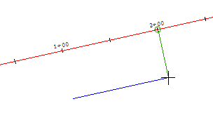

An alignment must exist in the drawing to use this command.
Click
Find.
- Select the alignment.
- Specify a station by either entering a station value or clicking in the drawing.
- Specify a distance by either entering an offset or clicking in the drawing.
- Specify a station and offset for the next point in the line. Or press Enter to return to the Line command prompt where you can use additional options to define the line.
