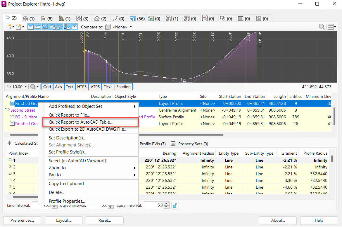

- From the Alignments tab of the Project Explorer window, locate the alignment Second Street, and right-click the associated profile: Finished Grade Centerline - Second Street Design.
- Ensure that the Calculated Stations sub-object tab is selected, then right-click the selected profile and select Quick Report to AutoCAD Table (Calculated Stations) from the right-click menu.

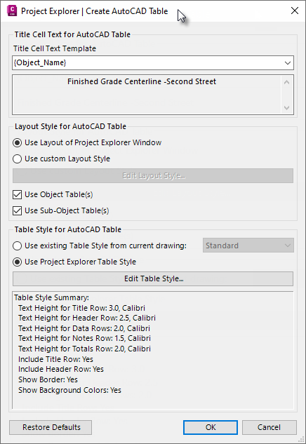

The Create AutoCAD Table dialog box opens.
Configuring the AutoCAD Table
To generate an AutoCAD table you need to configure the content, layout, and style of the table using a Layout Style and a Table Style.
Layout Styles define the heading, visibility, and order of every column of data in the AutoCAD table. The units of numerical values can also be controlled from a Layout Style.
Table Styles define the line color, text size and color, font, and cell margins for generated tables.
Layout and Table Styles can be saved and retrieved at any time, but for this tutorial you will define your requirements manually.

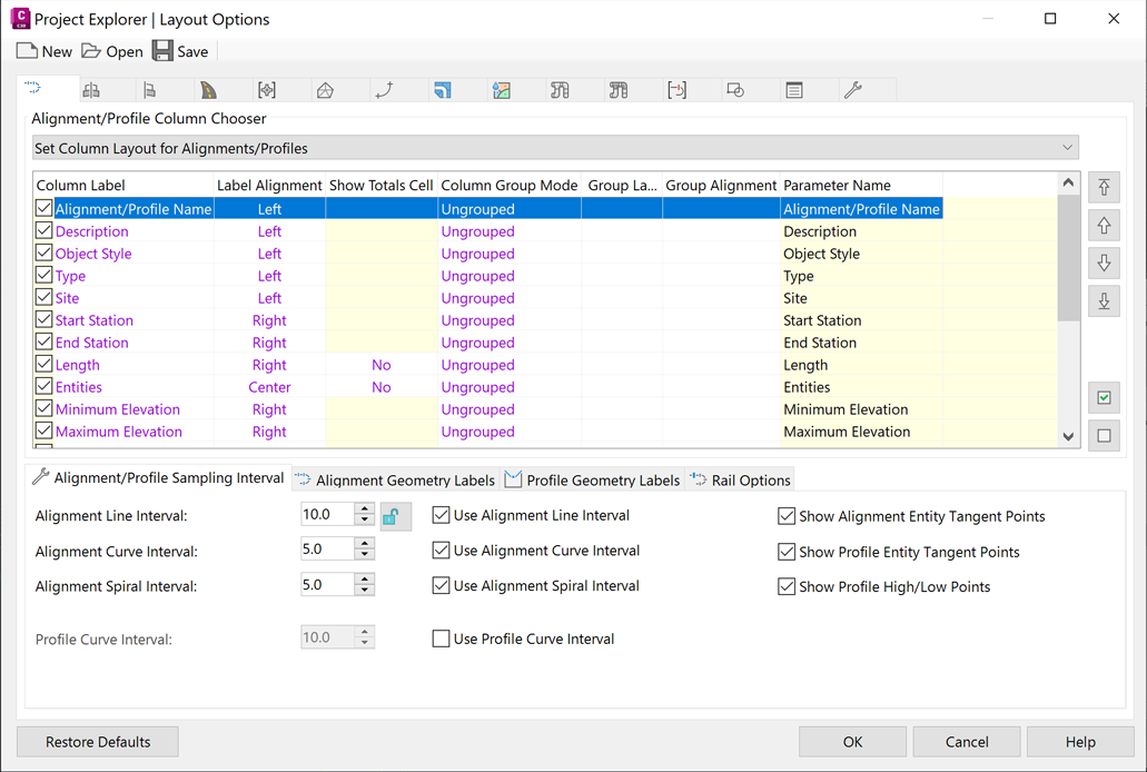

Change the Layout Style setting to Use a Custom Layout Style, then click the Edit Layout Style button.
The Layout Options dialog box opens.
From this dialog box you will define the layout of the AutoCAD table.
- On the Alignments tab of the Layout Options dialog box, ensure that Set Column Layout for Alignments/Profiles is selected.
- From the list view, ensure that just the following columns are selected: Alignment/Profile Name, Type, Object Style, Site, Start Station, End Station, Length.
- At this point, you may rename or reorder any of the selected columns to match the standards in your organization. Columns may be renamed by double-clicking on the required label, or by right-clicking and selecting Rename from the right-click menu.
- Change the drop-down list in the Alignments tab to Set Column Layout for Alignment/Profile Calculated Stations.
- From the list view, ensure that just the following columns are checked: Point Index, Station, Easting, Northing, Elevation, Bearing, Alignment Radius, Entity Type, Gradient, Profile Radius, Profile Entity. Rename and reorder the selected columns to your own requirements.
- From the Alignment/Profile Sampling Interval controls, set your desired interval for Lines, Curves, and Spirals. Changes applied here will only affect the content of the table.

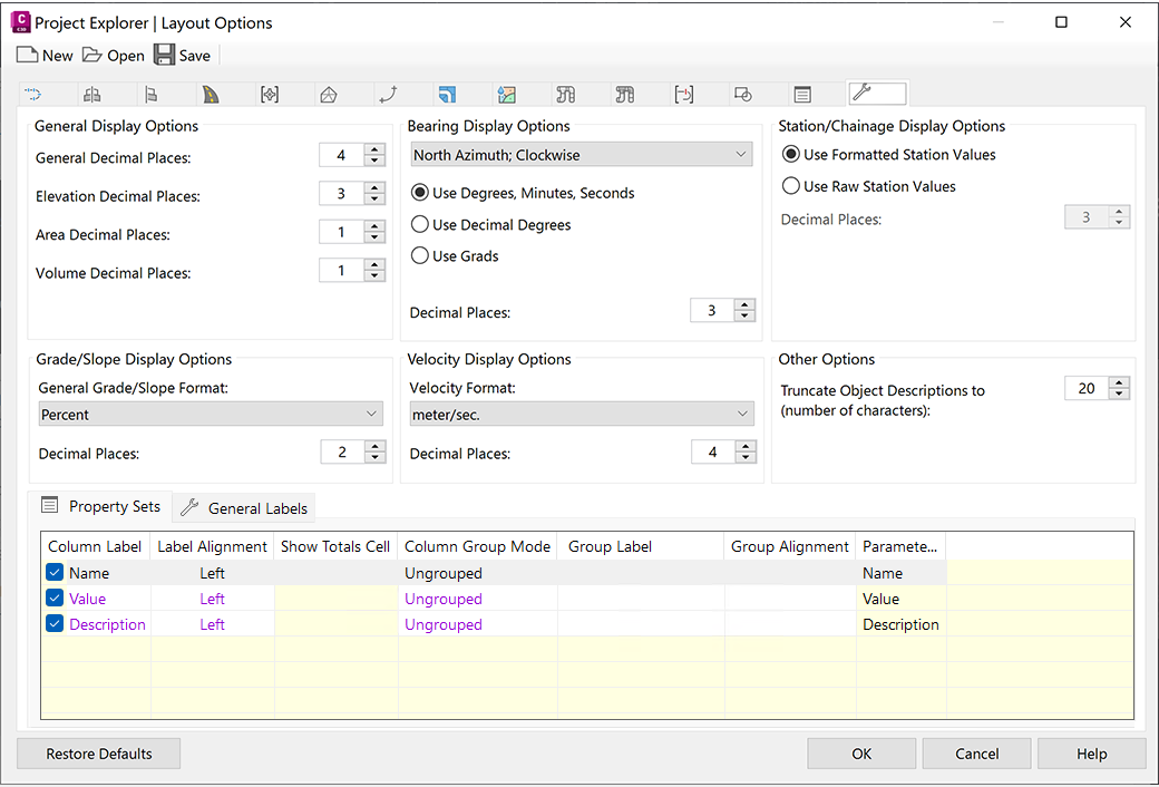

- Select the General tab and note the options here to set the format of numerical values such as angles/bearings, stations, elevations, and slopes. Again, changes applied here will only affect the content of the table.
Click OK to close the Layout Options dialog box and return to the Create AutoCAD table dialog. Next, you'll specify the style of the table.

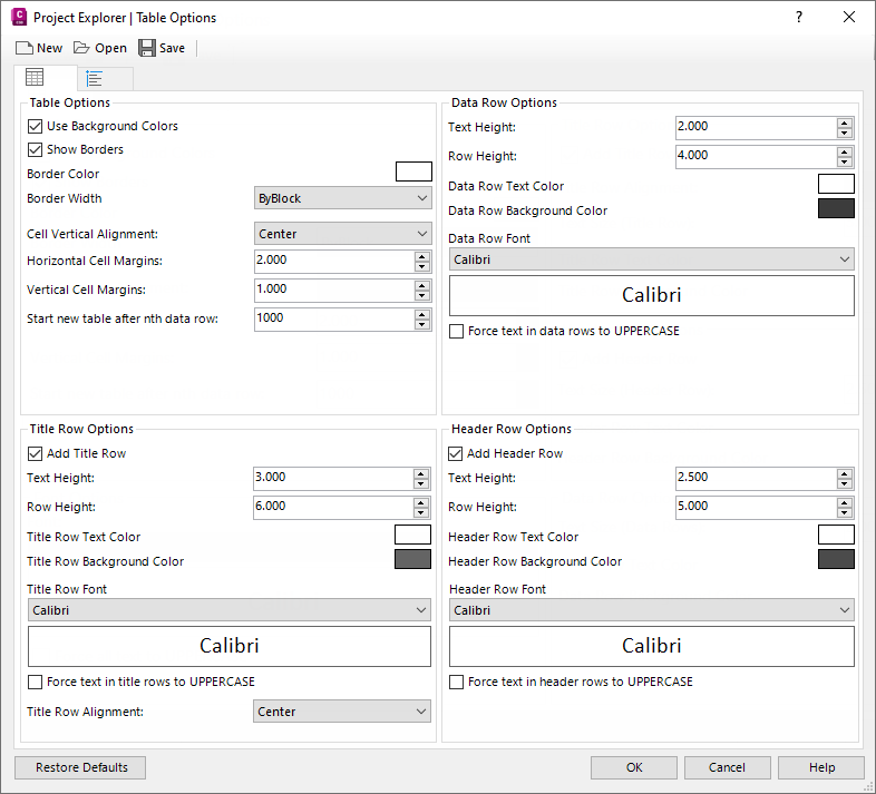

In the Create AutoCAD table dialog box, check that the Use Project Explorer Table Style option is selected then click the Edit Table Style button. The Table Options dialog box opens. This dialog allows you to define what the table will look like.
Set the table border color to Green, then modify other parameters of the table style to your own requirements.
Click OK to close the Table Options dialog and return to the Create AutoCAD table dialog box.

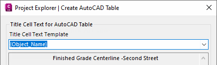

Title Cell Text
Note that the title row of the AutoCAD table can be derived from a series of dynamic variables during the creation process, or you can specify a fixed file name in this dialog box. By default, the title row will display the selected object name.
Generate the Table
You can now create the table in AutoCAD.
From the Create AutoCAD table dialog, click the OK button and pick an insertion point in the AutoCAD viewport. The table is created.

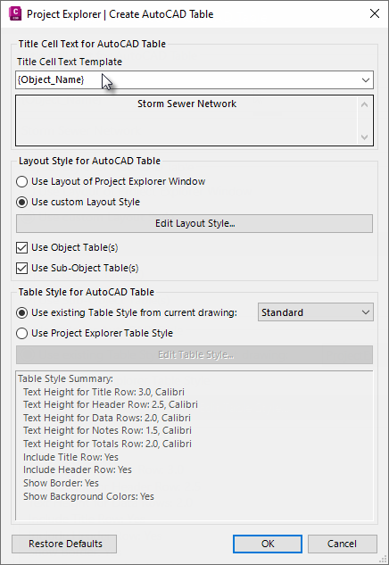

You'll configure the content, layout and style of the table using a Layout Style and a Table Style.
Change the Layout Style setting Use custom Layout Style, then press the Edit Layout Style button. The Layout Options dialog opens.

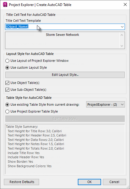

Table Style Options
To re-use the AutoCAD table style which was created for the alignment table, ensure that Use existing Table Style from current drawing is selected, and select Project Explorer - (1) from the list of existing table styles.
Generate the Table
From the Create AutoCAD Table dialog box, click the OK button and pick an insertion point in the AutoCAD viewport. The table is created.
