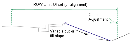

This subassembly inserts a daylight link from the attachment point to a given offset from the right-of-way limit on a target surface.
You can also specify optional lined materials for daylight and other links (All Links, Daylight Links, Fill Links Only, and None).
The attachment point is at the inside edge of the daylight link.

Behavior
The daylight offset is calculated as the ROW Limit Offset plus or minus the Offset Adjustment. A daylight link is inserted from the attachment point to the calculated offset on the target surface.
Like other daylight subassemblies, this subassembly optionally lets you add a lined material. You can specify three ranges of slopes. Material type 1 is applied if the slope of the links is up to the specified slope value. From slope 1 to slope 2, the second type of material applied. Similarly, if the slopes of links fall within slope 2 and slope 3 values, then material 3 is applied. If the link slopes are flatter than slope limit 3, then no material is applied.
If a lined material is added to the subassembly, then parallel links are added to the daylight links with specified thickness. This thickness parameter (for example, Material 1 Thickness) is measured perpendicular to the link. Bottom level links are coded with Datum and daylight links are coded with Top. Shapes enclosed by these materials are coded with material name.

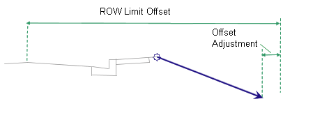

Layout Mode Operation
In layout mode, this subassembly displays a link extending outwards at a -4 : 1 slope to the right-of-way offset, plus or minus the offset adjustment. The daylight link terminates with an arrowhead pointing outwards.
