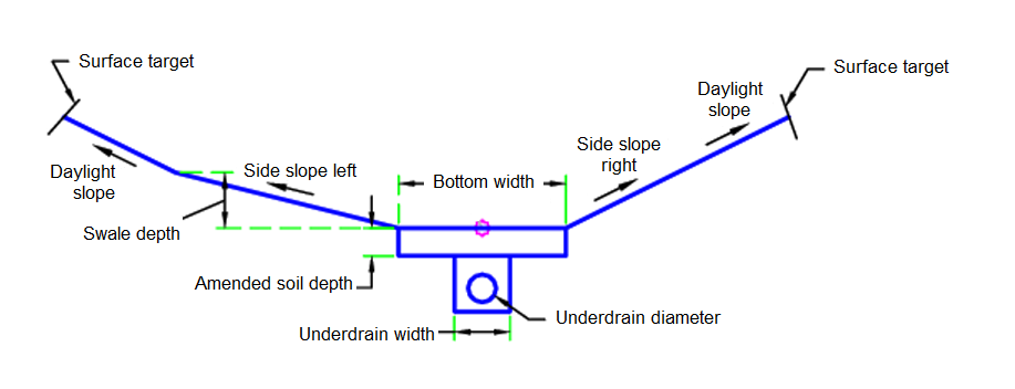

The VegetatedSwale subassembly creates a vegetated swale to treat storm water.
The attachment point is at the middle top of the vegetated swale.

Side Specifies which side to place the subassembly Left / Right Right
Bottom Width Swale bottom width Numeric, positive 3
Include Amended Soil Include amended soil under swale Yes / No Yes
Daylight Slope Daylight slope Numeric, positive 2 ( : 1 )
Amended Soil Depth Depth of amended soil Numeric, positive
0.5 ft
0.15 m
Underdrain Diameter Diameter of underdrain Numeric, positive
0.5 ft
0.15 m
Underdrain Depth Depth of underdrain Numeric, positive
1 ft
0.30 m
Underdrain Width Width of underdrain Numeric, positive
1 ft
0.30 m
Include underdrain Include underdrain Yes / No Yes
Swale Depth Depth of swale Numeric, positive
1 ft
0.30 m
Side Slope Left Left side slope Numeric, positive 4 ( : 1 )
Side Slope Right Right side slope Numeric, positive 2 ( : 1 )

Starting at the attachment point, the swale is built using the input parameters. If the surface target is set, the daylight surface is found (only for cut situations). If include underdrain is set to Yes, then the underdrain is built.
Layout Mode Operation
In layout mode, the vegetated swale is built.

P1 Flowline Flowline of the vegetated swale
P2, P3 Swale Edge of swale
P4, P5 Hinge
P6, P7 Daylight, Daylight_Cut
P10-P13 Underdrain
P14 Pipe_Invert Invert of underdrain pipe
L1-L4 Swale, Top Top of swale
L5, L6 Daylight, Daylight_Cut
L9 AmendedSoil, Datum Bottom of amended soil
L14 Underdrain, Datum Bottom of underdrain
S1 AmendedSoil
S2 Underdrain
Coding Diagram
