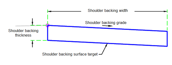

The ShoulderBacking subassembly inserts links and shapes to create a shape to represent shoulder backing.
The attachment point is at the inside edge of the shoulder backing. This component can be attached to either the left or right side.

Side Specifies which side to place the subassembly Left / Right Right
Shoulder Backing Width Width of shoulder backing Numeric, positive
2 ft
0.6 m
Grade of Shoulder Backing Grade of shoulder backing Numeric -5%
Thickness of Shoulder Backing Thickness of shoulder backing Numeric, positive
0.25 ft
0.08 m

Shoulder Backing Surface Name of the daylighting surface. The following object types can be used as targets for specifying the surface: surfaces. Optional

The initial point is set at the attachment point. The initial shoulder backing sides and top are constructed from the input parameters. The bottom inside and outside point elevations are checked against the target surface to determine if the point is in the cut or fill condition. If both are in, the bottom link is created at a matching grade of the top link.
If in fill, the shoulder backing bottom is extended to the surface target.
Layout Mode Operation
In layout mode, this subassembly draws the shoulder backing using the input parameters.

P1, P2 Backing Shoulder backing
P3, P4 Backing_Sub Bottom of shoulder backing
L1 Top, Backing Top of shoulder backing
L3 Datum Bottom of shoulder backing
S1 Backing Shoulder backing area
