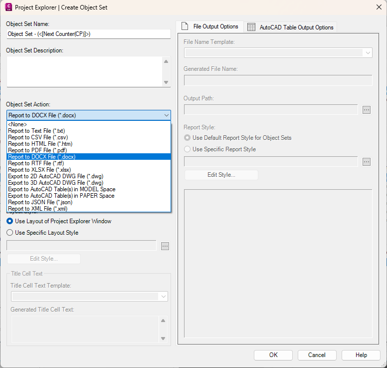

  2. Select the Object Sets tab in the Project Explorer window, then click the New Object Set button on the toolbar to start creating the first object set in the current drawing.
The Create Object Set dialog box opens.
Configuring the Object Set

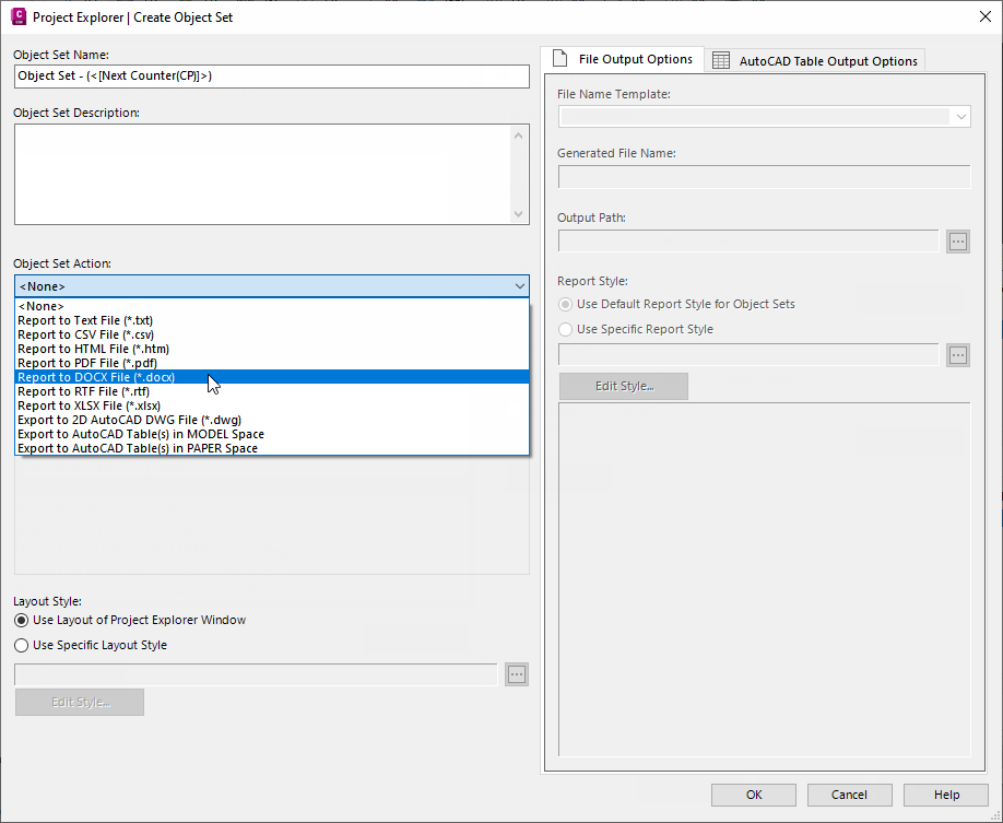

To define an object set which generates a report, you need to create a file name, file type, and output path for the report, then configure the content and layout of the report using a Layout Style and a Report Style.
  1. Select Report to DOCX File from the Action drop down list.
    Note that the file name of the outgoing report file can be derived from a series of dynamic variables, or you can specify a fixed file name in this dialog. In this case, you'll use the default option, the outgoing file name will be made up of a combination of the object set name and the drawing name.
  2. Set the required Output Path if desired.
  3. Change the Layout Style setting to Use Specific Layout Style, then click the Edit button to start defining the layout of this report.

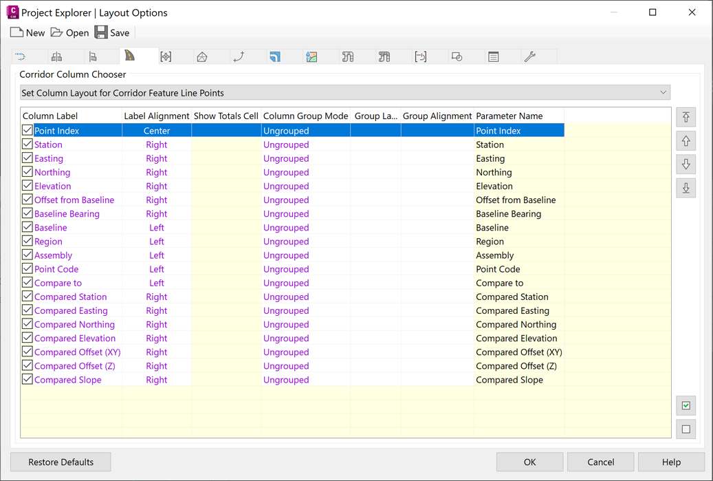

  1. On the Corridors tab of the Layout Options dialog box, ensure that Configure Column Layout for Corridor Feature Line Points is selected.
  2. From the list view, clear the following column labels:
    • Point
    • Region
    • Assembly

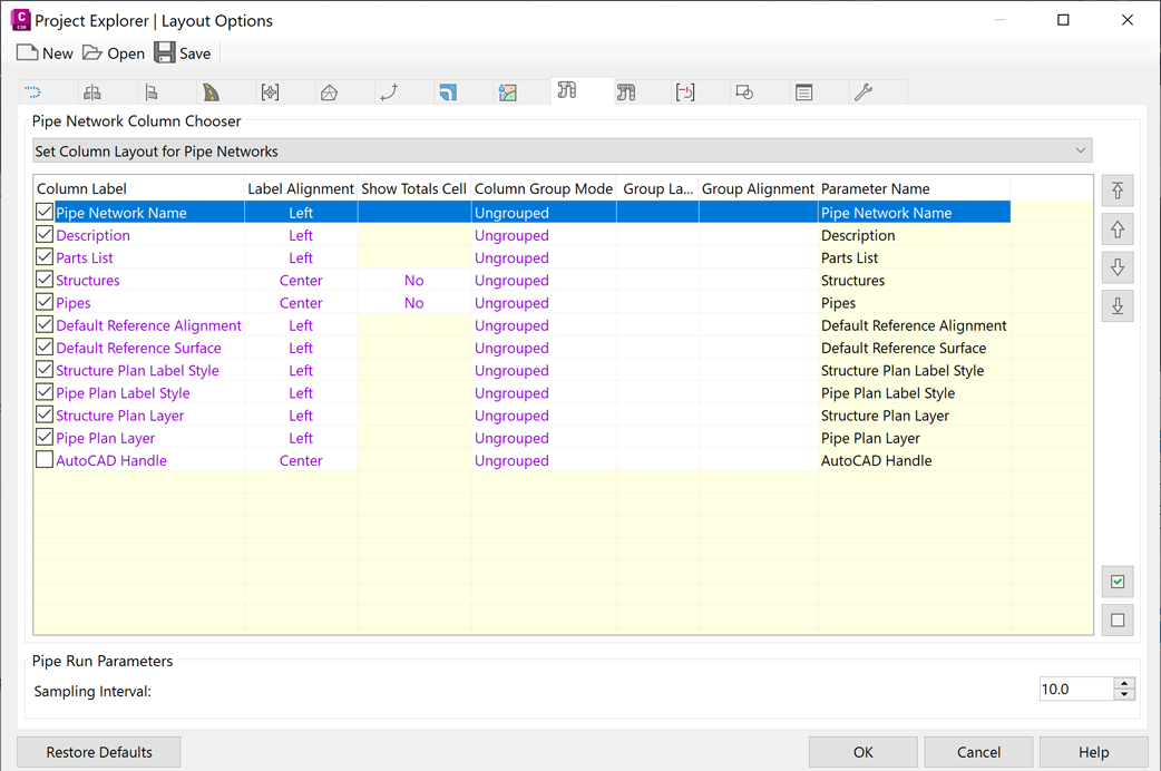

  3. On the Pipe Networks tab of the Layout Options dialog box, ensure that Configure Column Layout for Pipe Networks is selected.
  4. From the list view, clear the following column labels:
    • Structure Plan Label Style
    • Pipe Plan Label Style
    • Structure Plan Layer
    • Pipe Plan Layer

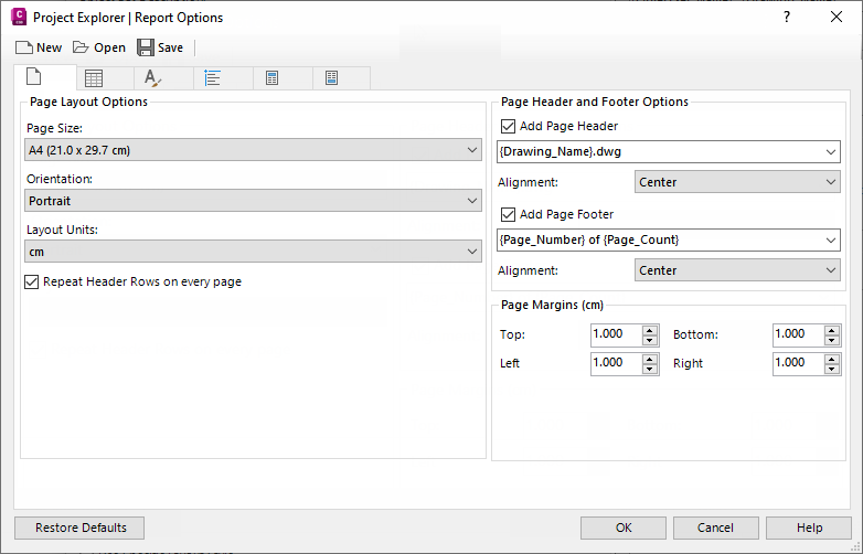

Report Style Options
Next, you'll set up a Report Style to determine the page formatting, fonts, table style, and header/footer content of the outgoing report.
  1. In the Create Object Set dialog, under the Report Style section, press the Edit button.
  2. The Report Options dialog opens.

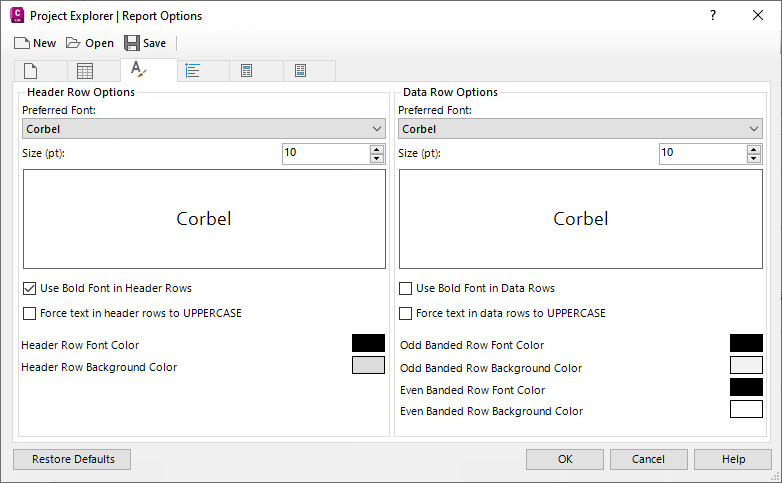

  3. On the Page Options tab, set the page size to A4, and the page orientation to Portrait.
  4. On the Font Options tab, set the preferred font to Corbel and the font size to 10pt.
  5. Save these settings to a Report Style and associate the resulting file with this object set. Click the Save button, and save the report style to a path and file name of your choice.
  6. Click OK to close the Report Options dialog and return to the Create Object Set dialog.

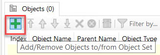

  1. On the Object Sets tab of the main Project Explorer window, click the Add/Remove Object(s) to/from Object Set button.
  2. On the Corridors tab of the resulting dialog, select the First Street corridor and click OK.

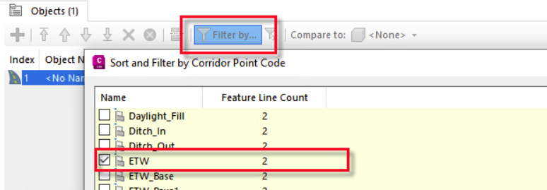

  3. Optionally, you can now specify the corridor feature lines to include in your report by adding a point code filter. Click the Add/Edit Filter button to open the Sort and Filter Content dialog. Select the ETW point code and click OK.

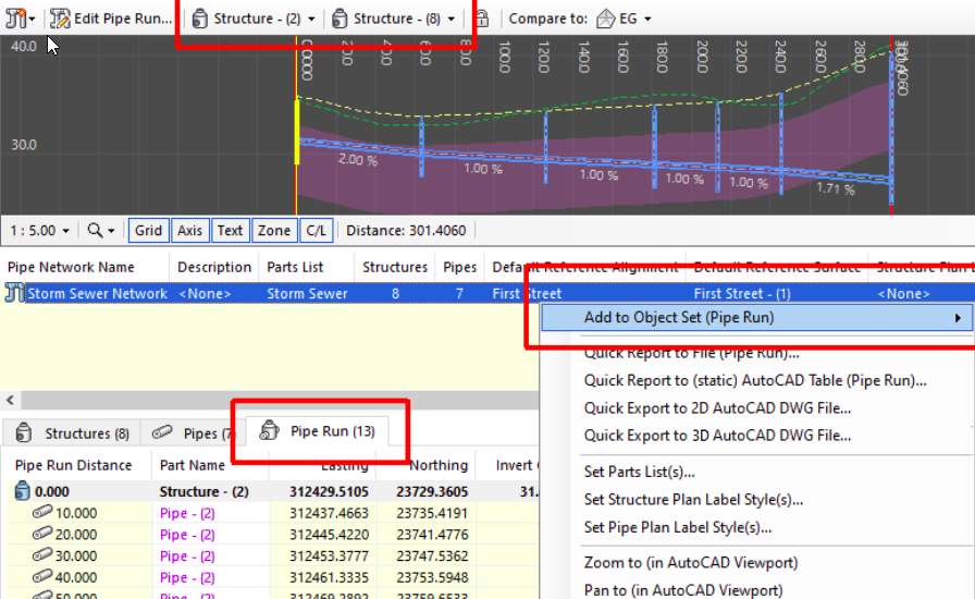

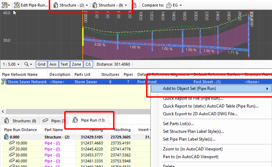

To add a pipe run from the Pipe Networks tab
  1. Open the Pipe Networks tab of the main Project Explorer window. From the main toolbar, set the start structure of the Pipe Network profile view to Structure - (2) and the end structure to Structure - (8). This determines the path and route of the displayed pipe run. Set the comparison surface of the pipe run to First Street - (1).
  2. Ensure that the Pipe Run sub-object category tab is selected, then right-click the selected pipe network from the list. From the right-click menu, select Add to Object Set (Pipe Run), then select Object Set - (1) from the related sub-menu. The selected pipe run is added to your object set.
  3. Return to the Object Sets tab to verify that there are now two objects listed in your object set.

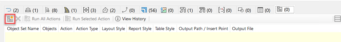

  4. At this point, you can test the report creation process from your new object set by clicking the Run Selected Action button on the Object Sets tab of the main Project Explorer window.

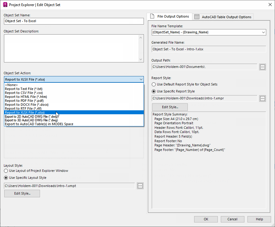

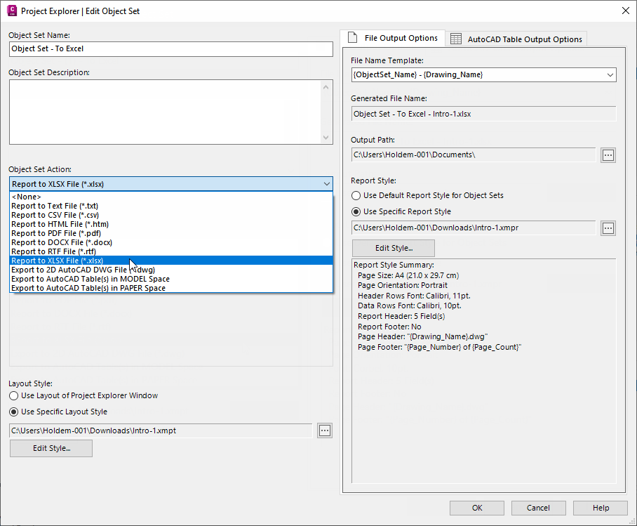

You can now use Object Sets to generate this report to two different file formats simultaneously. You can achieve this by duplicating this object set, and making a few edits to the duplicate.
  1. On the Object Sets tab of the main Project Explorer window, right click your existing object set and select Copy from the right-click menu.
  2. Right-click again and select Paste from the menu. You now have two identical object sets containing the same objects and filters.
  3. Double-click the new object set to open the Edit Object Set dialog, then change the Action to Report to XLSX File.
  4. Change the Object Set name from Object Set - (1) - Copy to Object Set - (1) to Excel.
  5. Click OK to close the Edit Object Set dialog box and return to the main Project Explorer window.

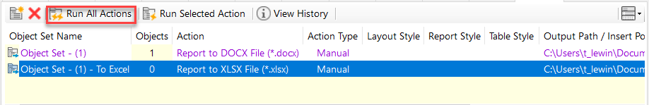

  6. Use the same technique to change the name of the first object set to Object Set - (1) to Word. You have now defined two Object Sets which are identical apart from the file type of the generated report.
  7. Click the Run All Actions button in the main toolbar. Actions are processed from all object sets in the drawing, which in this case will cause your report to simultaneously be written to a DOCX file and an XLSX file. Review the resulting files in Microsoft Word and Microsoft Excel.
Here is the resulting file as it looks in Microsoft Excel, with each object in the Object Set written to a separate worksheet:
