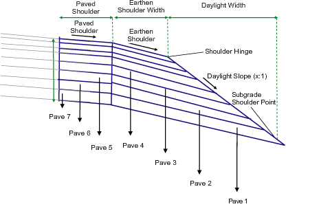

This subassembly inserts a paved and an earthen (unpaved or gravel) shoulder with all pavement, base, and subbase layers extended to the subgrade shoulder point.
The attachment point is at the beginning of the first link. This subassembly is sensitive to the direction being inserted. Positive widths increase the offset from the attachment point in the direction inserted.

Behavior
The shoulder is inserted using width and depth parameters provided. The slope of the subgrade surface can also be set using a parameter reference that sets the slope equal to that of the subgrade surface of an adjacent lane. You can also enter a fixed slope, if desired. The slopes of all base surfaces will follow the slope of the subgrade surface. When an alignment is used to define the Width to Subgrade Shoulder Point, the Foreslope of the Shoulder parameter is ignored. The shoulder subassembly ties in to the pavement layers (even if the outside edges of the pavement layers are extended).

Coding Diagram
