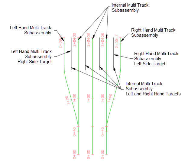

By default, the attachment point is at the centerline between the rails. The track can be moved relative to this point using the subassembly parameters.

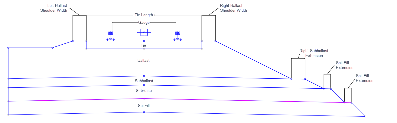

| Minimum Ballast Depth | The minimum vertical distance between the bottom of the tie and the top of the subballast. The location of this minimum distance changes at different stages in cant. See Behavior below. | Numeric, non-negative | 12"
305 mm |
| Ballast Shoulder Width (Left and Right) | The distance from the end of the tie to the beginning of the ballast side slope. | Numeric, non-negative | 12"
305 mm |
| Ballast Side Slope (Left and Right) | The slope of the side of the ballast material. The slope of the top of the ballast material matches the slope of the tie that results from cant. | Slope, non-negative | 2:1 |
| Subballast Depth | The depth of the subballast material | Numeric, non-negative | 8"
203 mm |
| Subballast Top Slope (Left and Right) | The top slope of the left and right sides of the subballast with the centerline of the subassembly as the hinge point. | Slope, non-negative | 40:1 |
| Subballast Side Slope | The slope of the side of the subballast material. | Slope, non-negative | 2:1 |
| SubBase Extension | The distance from the toe of the subballast material to the beginning of the side slope of the subbase material | Numeric, non-negative |
0.5 ft 0.15 m |
| SubBase Slope | The slope of the side of the SubBase material. | Slope, non-negative | 1:1 |
| SubBase Depth | The depth of the SubBase material | Numeric, non-negative |
1 ft 0.30 m |
| Soil Fill Depth | The depth of the Soil Fill material | Numeric, non-negative |
1 ft 0.30 m |
| Soil Fill Slope | The slope of the side of the Soil Fill material. | Slope, non-negative | 1:1 |
| Soil Fill Extension | The distance from the toe of the subbase material to the beginning of the side slope of the Soil Fill material | Numeric, non-negative |
0.5 ft 0.15 m |
| Omit Rails | Prevents the rail points, links, and shapes from being drawn. | Yes/No | No |
| Omit Tie | Prevents the tie points, links, and shapes from being drawn. | Yes/No | No |
| Omit Ballast | Prevents the ballast points, links, and shapes from being drawn. If this option is set to Yes then the subballast is also not drawn. | Yes/No | No |
| Omit Subballast | Prevents the subballast points, links, and shapes from being drawn. If the Omit Ballast option is set to Yes then the subballast is not drawn regardless of this setting. | Yes/No | No |
| Omit SubBase | Prevents the subbase points, links, and shapes from being drawn. If the Omit Ballast or subballast option is set to Yes then the Sub Base is not drawn regardless of this setting. | Yes/No | No |
| Omit Soil Fill | Prevents the soil fill points, links, and shapes from being drawn. If the Omit Ballast, subballast, or subbase option is set to Yes then the soil fill is not drawn regardless of this setting. | Yes/No | No |
Target Parameters
This section lists the parameters in this subassembly that can be mapped to one or more target objects. For more information, see To Specify Corridor Targets.
Parameter |
Description |
Status |
| LeftSideOffset | Left Side Offset | Optional |
| LeftSideElevation | Left Side Elevation | Optional |

Rail Detail
The rail shape used in this subassembly is a simplified approximation of industry standard rail shapes and dimensions. Rail Head Width, Rail Depth, and Rail Base Width are available as input parameters and are used to derive the remaining approximated dimensions.
Layout Mode Operation
In layout mode the subassembly displays the links comprising the rails, tie, ballast, subballast, and side slopes.
