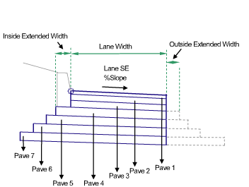

Each layer has its own separate extension options both on the inside and outside. The inside and outside extensions specify the additional width on the inside or outside relative to the pavement layer immediately above.
Example 1:
In the following example, the Pave4 Inside Extended Width is 0.5 meters. The Pave4 Outside Extended Width is zero. If this subassembly is inserted on the right side, it is drawn as shown in the following illustration.
Example 2:
In the following example, the Pave4 Inside Extended Width is 0.5 meters. The Pave4 Outside Extended Width is 0.6 meters. If this subassembly is inserted on the right side, it is drawn as shown in the following illustration.
The extension widths will always be specified as positive widths.
The pavements layer widths may be specified using the following methods:
- by specifying that the pavement width be the same as the pavement immediately above
- by specifying a pavement width
- by specifying an inside and outside pavement layer extended width so that pavement layer width will be the distance between the inside and outside offsets
- by specifying an inside pavement layer extended width and pavement width so that the outside pavement layer is automatically calculated
