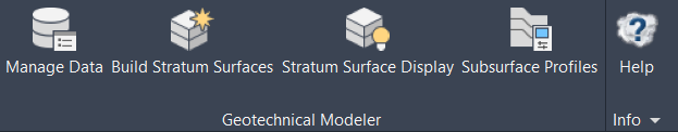

From the ribbon, select the Geotechnical Modeler tab
Select the appropriate Geotechnical Modeler interface to open:
You can also choose to enter the command prefix GM from the command line as an alternate method to access the Geotechnical Modeler dialog boxes. The following commands are available from the command line to access the Geotechnical Modeler dialog boxes:
- GM_ManageData
- GM_BuildSurfaces
- GM_StratumSurfaceDisplay
- GM_SubsurfaceProfiles
- GM_Help

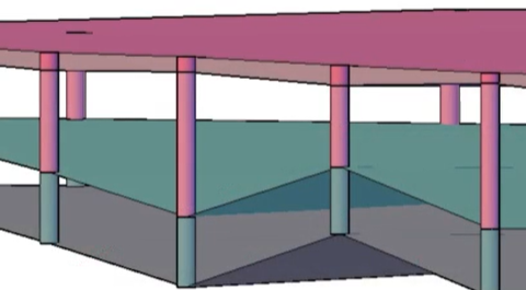

After importing your Geotechnical Modeler information into the model, you can create stratum surfaces that will represent each material layer from the borehole data. You can control the display of the stratum surfaces for the plan view and the model view separately.

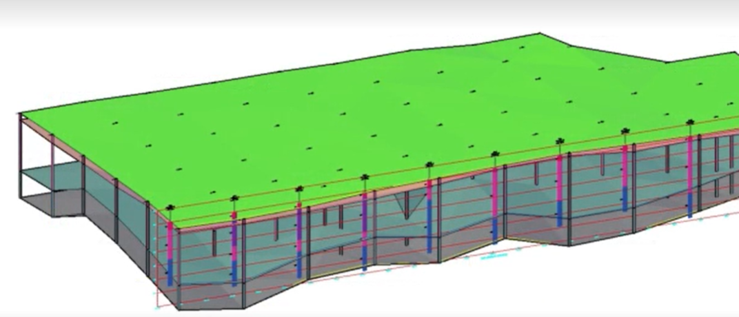

If you want to better visualize borehole data, you can create 2D sticklogs to better understand the geotechnical data. You can also create 3D sticklogs to view the boreholes stratum surface in 3D.

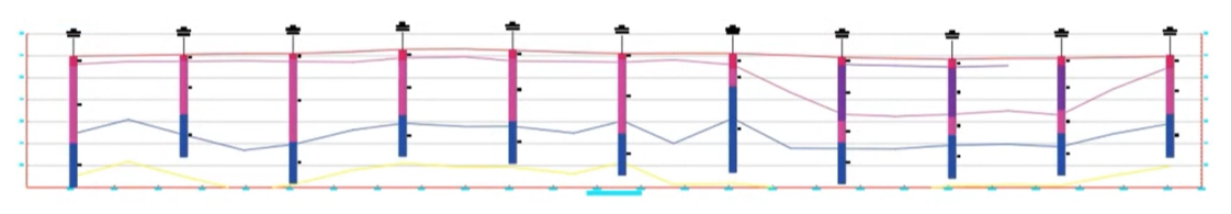

A subsurface profile view represents the different stratum profiles and the boreholes themselves. Select the boreholes you'd like to add to the profile and they're added when the profile view is generated. The profile view can be utilized in the design plan sheets but can also be added in 3D.
Bringing this information together in a 3D view can help you to make better design decisions. You can also import the model into InfraWorks from Civil 3D allowing stakeholders to have a better understanding of problems when working on the site design.
