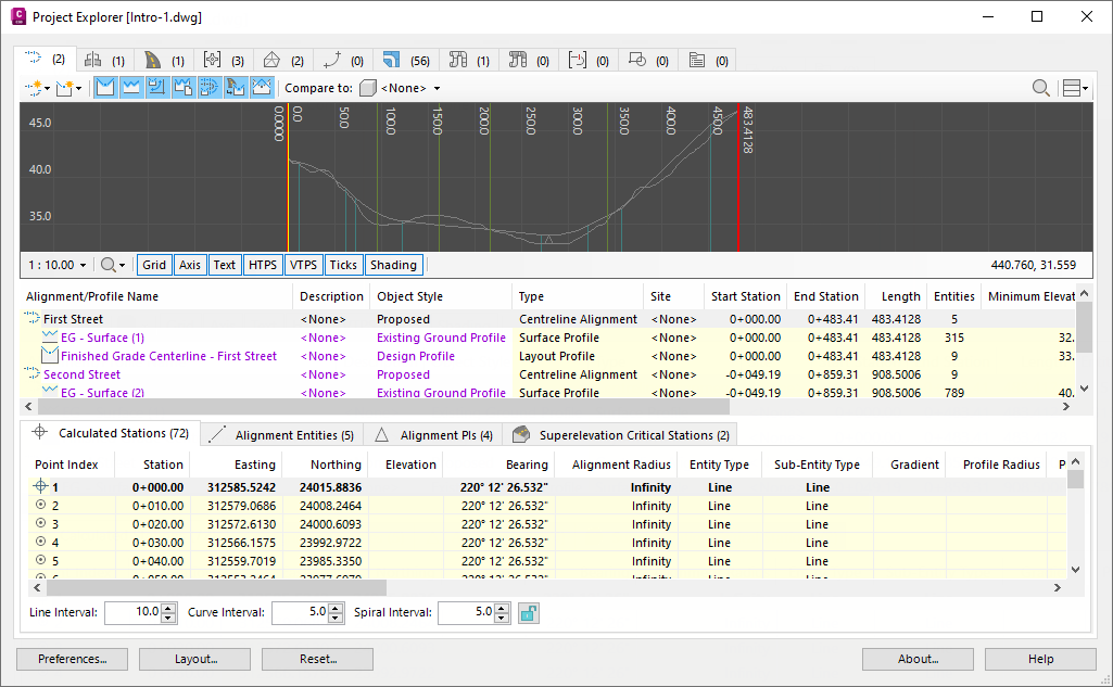

After installing, the Project Explorer window is found under the Add-in tab of the Civil 3D ribbon. You can also access the product Project Explorer by typing “ProjectExplorer” at the Command Prompt.
Visit the Project Explorer learning path to learn how you can use Project Explorer inside of Civil 3D to streamline your design process.
Working in the Project Explorer Window
The Project Explorer window displays live geometric project data used in the Civil 3D model. When project data is modified or added to the model, the content displayed in the Project Explorer window will automatically update. To offer greater control over how project data displays in the window, you can customize the window.
The Project Explorer window displays live geometric project data used in the Civil 3D model. When project data is modified or added to the model, the content displayed in the Project Explorer window will automatically update. By selecting an element in the Project Explorer window and pressing the CTRL button, you can highlight the element in the AutoCAD viewport. To offer greater control over how project data displays in the window, a template based approach is used to customize the window.
Using dynamic profile and section views in Project Explorer can help to review the design more efficiently. Additionally, support for multiple object editing can help to streamline the process of making multiple design changes in Civil3D.
