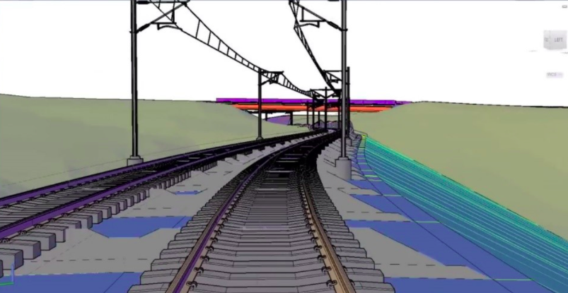

Civil 3D provides users with a host of tools needed to create and modify rail designs. Using Civil 3D, you can identify the most efficient geometry for your rail design.
Rail design in Civil 3D isn't one linear workflow, but rather a set of features working together to help you design and analyze a railway system.

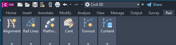

Rail design tools can be found on the Rail ribbon tab. Hover over one of the rail design buttons to show a drop-down menu with the options to create, edit, and delete the respective rail element.

Click Rail tab
Rail Line panel
Create.
In the Rail Lines dialog box, specify the required lines, object type, labels, profile, creation method, and other parameters for the rail line.
