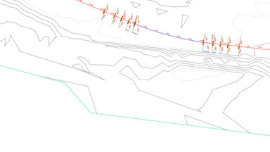

With Shared Views, visual representations of Autodesk Civil 3D drawings can be easily shared with clients and stakeholders
sv card
What Is It?
Collaboration is at the center of any civil infrastructure design project. By understanding the needs and concerns of stakeholders, you and your team can more effectively develop your designs. With Shared Views, visual representations of Autodesk Civil 3D drawings can be easily shared with clients and stakeholders through a browser-hosted platform, complete with measure and comment functionalities.
Why Should I Use It?
During the design workflow, designers can efficiently share ideas and progress by creating a shared view and sharing a link to it. Anyone with the link can view and comment on the shared view without needing to have Civil 3D installed.

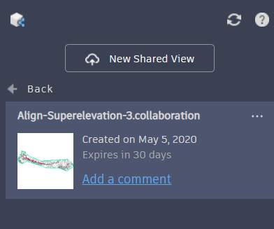

  1. To use Shared Views, open the drawing you want to share a view of.
  2. Click Collaborate tab glyph Share panel.
  3. In the Shared Views panel, click New Shared View.
    new_view
  4. Enter a name for your shared view.
  5. Select which view you want to share. You have the option to share the current view or share the model view and all layout views.
    • You also have the option to share object properties. If you select the Share Object Properties check box, properties of the objects within the extents of the shared view will be included. Anyone with access to your shared view will be able to review this data.
  6. Select Share to create a visual representation of the drawing in the Autodesk Viewer. Civil 3D will begin processing your shared view. Your shared view will appear in the Shared Views panel after the processing is complete.
  7. After the processing is complete, click ellipses next to the shared view. From the drop-down menu, you can copy a link to the shared view, open the shared view in your default browser, extend the shared view, or delete the shared view.
