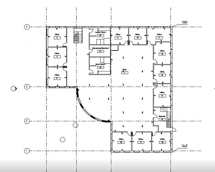

In this example, a building has been created in Revit, and the same building is featured in a Civil 3D drawing. Using the Shared Reference Point extension, you will adjust the Revit project to sync with the coordinate system used in Civil 3D.
A building created in Revit, and the same building geolocated in Civil 3D SRPU

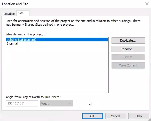

  9. To update the model to the new coordinate system, go to the Manage tab and select Location.
  10. From the Site tab in the Location dialog box, select the new coordinate system and click Make Current.
  11. Once you've set the new coordinate system, go to the Properties palette and change the Orientation from Project North to True North. After changing the orientation, the Revit model will be oriented using the same coordinate system used in the Civil 3D drawing.
