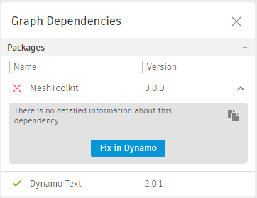

Go to the Options menu in Dynamo Player and select Graph Dependencies. If the graph you are trying to run in Player is missing any dependencies, you will see a warning near the bottom of the Player application. You can also click this warning to open the Graph Dependencies dialog.

If the graph you have open in Dynamo Player relies on any dependencies, they will be listed in the Graph Dependencies dialog, sorted under headers:

In addition to a name and version, each dependency is accompanied by an icon.
- A checkmark means that the dependency is installed.
- An X means that the dependency is missing and needs to be installed in Dynamo.
- A warning icon means that there is a version mismatch in the installed dependency. The graph may still run, but if there are issues, try installing the correct dependency version in Dynamo.

The Graph Dependencies dialog provides a simple way to view dependencies without having to open Dynamo. Missing dependencies can be installed in Dynamo. If dependencies are missing, the dialog will include a Fix in Dynamo button to open Dynamo and install the missing dependencies in the Workspace References extension. You can also access this extension from Dynamo by going to Extensions > Show Workspace References.
