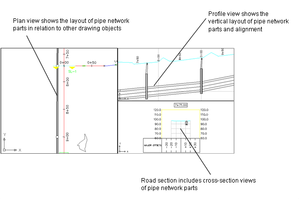

Pipe Network Viewports
This illustration displays three viewports: the pipe network in plan view, the profile view of some of the network pipes and structures, and the same parts in a section view.
The left pane shows a pipe network segment made up of two manhole structures connected by pipes. The network parts have been placed at a specified offset from an alignment, and are drawn in a profile view created using the same alignment (upper-right pane). A sample line placed at station 7+71 was used to create a section view (lower-right pane) that shows a cross-section view of the pipe network parts located at the station.
You can edit the positions of the pipe network parts manually by using editing grips in either plan, profile, or section view, or by directly editing their properties.
Layout, profile, and section views of a pipe network segment
