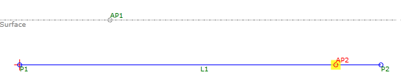

In this example, the Auxiliary Intersection (AP2) is created at the intersection of L1 and a specified slope from AP1. The slope is extended and reversed.
