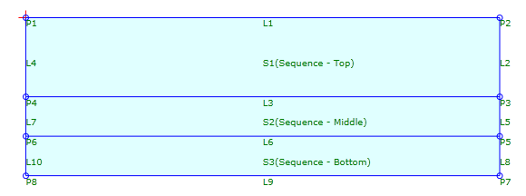

In this example, the subassembly is composed of three sequences that form top, middle, and bottom layers. The Sequence - Top layer was created first, and then the Sequence - Middle layer was built onto it. Finally, the Sequence - Bottom layer was built onto the Sequence - Middle layer.
