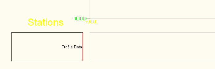

This sample demonstrates the creation of a data band style displaying section elevation data at two different locations:
Dim oBandProfileDataStyle As AeccBandProfileDataStyle
Set oBandProfileDataStyle = oDocument.ProfileViewBandStyles _
  .ProfileDataBandStyles.Add("Profile Band")
With oBandProfileDataStyle
    ' Add ticks and labels to each horizontal
    ' geography location.
    .HGPLabelDisplayStylePlan.Visible = True
    .HGPTickDisplayStylePlan.Color = 10 ' red
    .HGPTickDisplayStylePlan.Visible = True
    .HGPLabelStyle.TextComponents.Item(0).Contents = _
      "<[Station Value(Uft|FS|P0|RN|AP|Sn|TP|B2|EN|W0|OF)]>"
    .HGPLabelStyle.TextComponents.Item(0).Color = 11 ' red
    .HGPLabelStyle.TextComponents.Item(0).Visibility = True
    ' Modify how the title is displayed.
    .TitleBoxDisplayStylePlan.Color = 10 ' red
    .TitleBoxDisplayStylePlan.Linetype = "DOT"
    .TitleBoxDisplayStylePlan.Visible = True
    .TitleBoxTextDisplayStylePlan.Color = 80 ' green
    .TitleBoxTextDisplayStylePlan.Visible = True
    .TitleStyle.Text = "Profile Info"
    .TitleStyle.TextHeight = 1.0
    .TitleStyle.TextBoxWidth = 2.0
    ' Hide the rest of the information locations.
    .VGPLabelStyle.TextComponents.Item(0).Visibility = False
    .MajorIncrementLabelStyle.TextComponents.Item(0). _
      Visibility = False
    .MajorStationLabelDisplayStylePlan.Visible = False
    .MajorTickDisplayStylePlan.Visible = False
    .MinorIncrementLabelStyle.TextComponents.Item(0). _
      Visibility = False
    .MinorStationLabelDisplayStylePlan.Visible = False
    .MinorTickDisplayStylePlan.Visible = False
    .VGPLabelDisplayStylePlan.Visible = False
    .VGPTickDisplayStylePlan.Visible = False
    .StationEquationLabelStyle.TextComponents.Item(0). _
      Visibility = False
    .StationEquationLabelDisplayStylePlan.Visible = True
    .StationEquationTickDisplayStylePlan.Visible = True
End With
This style produces a data band that looks like this:
