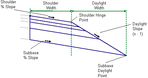

This subassembly inserts a paved shoulder with all pavement, base, and subbase layers extended to the shoulder daylight slope.
The attachment point is at the inside edge of the paved shoulder, which is typically at the outside edge-of-traveled way.

Behavior
The finish grade of the shoulder is inserted for the given Shoulder Width and Default Shoulder Slope outward from the attachment point. The subbase link is inserted from the attachment point starting at the Subbase Depth below the finish grade.
The shoulder daylight link can be inserted with either a fixed slope (Hold Daylight Slope = True), or a fixed width (Hold Daylight Slope = False). If a fixed slope is used, the daylight link is extended from the outside edge of the shoulder until it intersects the subbase link. Otherwise, the subbase layer is extended for the Daylight Width beyond the outside edge of the shoulder, and the daylight link is connected to the end of the subbase.
The Pave1, Pave2, and Base surface links are inserted parallel to the finish grade at the given depths until they intersect with the shoulder daylight link.

Point, Link, and Shape Codes
The following table lists the point, link, and shape codes for this subassembly that have codes assigned to them. Point, link, or shape codes for this subassembly that do not have codes assigned are not included in this table.
Type |
Code |
Description |
P2 |
EPS |
Edge of paved shoulder, finish grade |
P4 |
EPS_Pave1 |
Edge of paved shoulder on Pave1 |
P6 |
EPS_Pave2 |
Edge of paved shoulder on Pave2 |
P8 |
EPS_Base |
Edge of paved shoulder on Base |
P10 |
Daylight_Sub |
Subbase daylight point |
L1 |
Top, Pave |
Paved finish grade |
L3 |
Pave |
L4 |
Pave1 |
Top of Pavement2 |
L6 |
Pave1 |
Top of Pavement2 |
L7 |
Pave2 |
Top of Pavement3 |
L9 |
Pave2 |
Top of Pavement3 |
L10 |
Base |
Top of the base course |
L12 |
Base |
L13 |
SubBase, Datum |
Bottom of subbase, datum |
L14 |
Slope_Link | Top surface formation. L14 is the link connecting P2-P10 or P2-P8 or P2-P6 or P2-P4, depending on which is the lowest link |
S1 |
Pave1 |
S2 |
Pave2 |
S3 |
Base |
S4 |
SubBase |
L14 is the new link connecting P2-P10 or P2-P8 or P2-P6 or P2-P4, depending on which is the lowest link.
Coding Diagram
