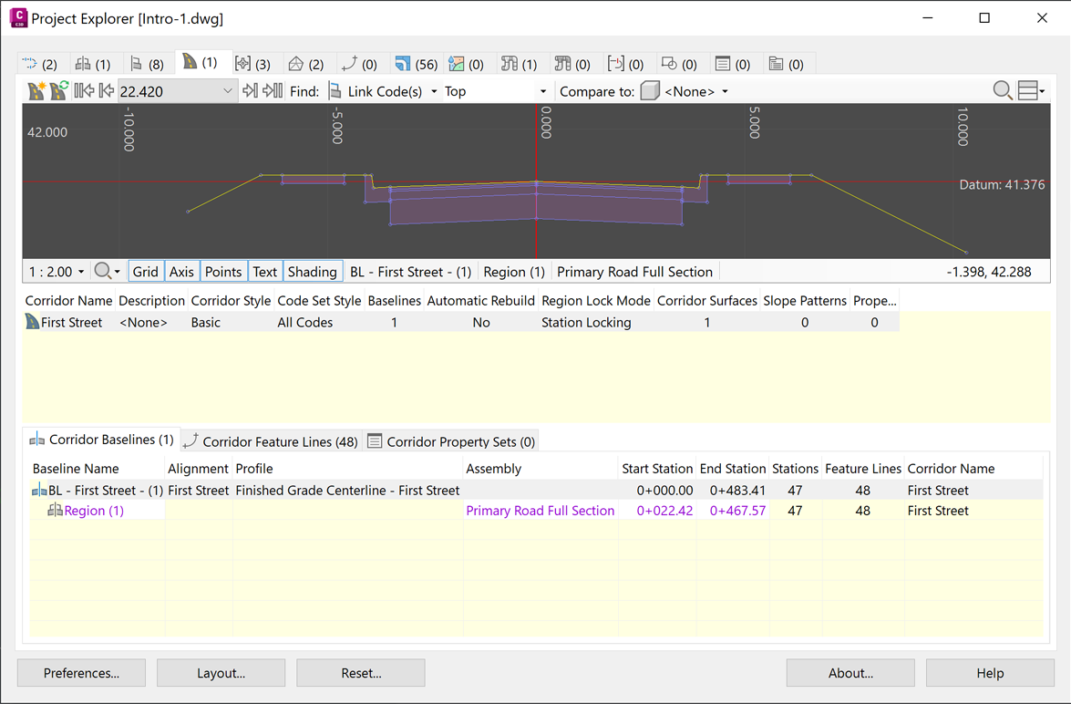

The Layout Options window is accessed from the Layout Options button in the lower left corner of the main Project Explorer window.

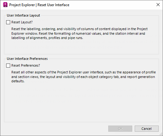

Reset layout options
The Layout Options which are currently assigned to the Project Explorer window can be reset to the default settings in one of two ways:
By clicking the Reset Layout button in the bottom left corner of the main Project Explorer window.
- By opening the Layout Options window and clicking the Restore Defaults button in the bottom left corner of the window.

User Interface Preferences are controlled from the Preferences window which is accessed from the Preferences button in the lower left corner of the main Project Explorer window.

Although Preferences are generally controlled from the Preferences window, there are a few commonly used Preferences settings which can also be set from Quick Access controls in the main Project Explorer window:
- General: Right-click any Object Category tab in the Project Explorer window to directly control the visibility of each Object Category tab.
- General: Right-click any Object Category tab in the Project Explorer window to control whether full Object Category Labels are displayed in the tabs.
- General: Use the Pane Layout buttons in the top right corner of the Project Explorer window to control the layout of information panes within each Object Category tab.
- General: For every Profile and Section View in the Project Explorer window, the scale factor and visibility of labels, the grid, and other content items can be controlled.
- Alignments: Filter buttons in the main toolbar of the Alignments tab allow the content of the Alignments/Profiles list to be filtered by Profile Type.
- Surfaces: Filter buttons in the main toolbar of the Surfaces tab allow the content of Surfaces list to be filtered by Surface Type.
- Pipe Networks: Filter buttons on the main toolbar of the Pipe Networks tab allow the content of the Pipes and Structures lists to be filtered in a number of ways.
- Pipe Networks: A button in the toolbar of the Pipe Network View allows the start/end structure to optionally be locked to the currently selected pipe.
Reset preferences
Preferences which are currently assigned to the Project Explorer window can be reset to the default settings by opening the Preferences window and clicking the Restore Defaults button in the bottom left corner of the window.
Adjusting Pane Layouts in the Project Explorer window
Pane Layout buttons are situated in the top-right corner of each of the key Object Category tabs. These buttons are used to control the layout of each individual pane of information in the selected tab, and are an ideal way to simplify the user interface in cases where the full set of information panes is not required to carry out a given task.

Reset user interface
To reset the user interface preferences and/or layout at any time, clicking the Reset button in the lower left corner of the main Project Explorer window.
