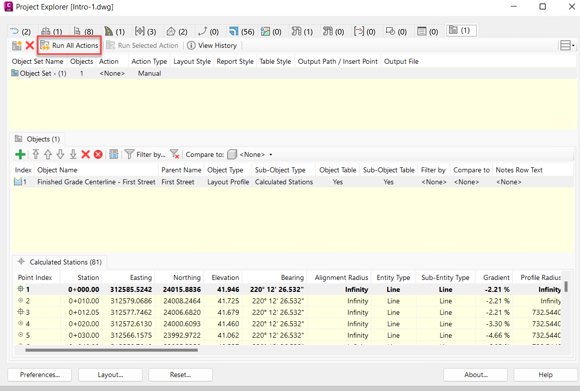

About Working With Object Sets
The Object Sets tab in the main Project Explorer window allows one ore more sets of objects to be persistently defined in your AutoCAD drawing. Object Sets are particularly useful for automating the generation of one or more reports from your drawing.
Actions may be associated with each Object Set, and these actions can be triggered with just a single mouse click. For example, a report generating action could be used to create a report file using a pre-configured Layout Style, Report Style, Output File Name, and Path.

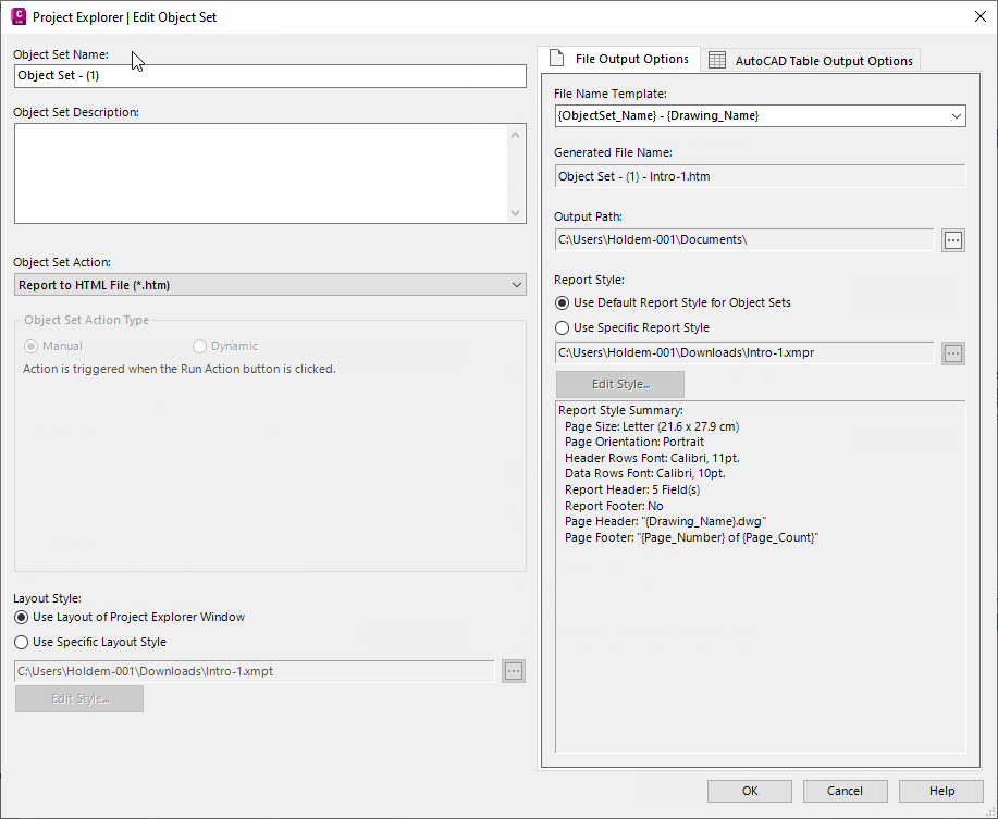

Creating an Object Set
Object Sets can be created from the Create Object Set dialog box, which can be accessed in two ways.
  • Navigate to the Object Sets tab in the Project Explorer window, and click the Create Object Set... button.
  • Right-click any object in the Project Explorer window and select the Add to Object Set Create Object Set... menu item.
Object Set name
A unique name must be assigned to each Object Set.
Object Set description
An optional description may optionally be assigned to each Object Set.
Object Set action and action type
An optional Object Set Action may be assigned to each Object Set. Actions are generally used to automate the process of generating reports, spreadsheets, or AutoCAD tables. The Object Set Action Type parameter determines how the assigned action should be triggered - either manually or dynamically.

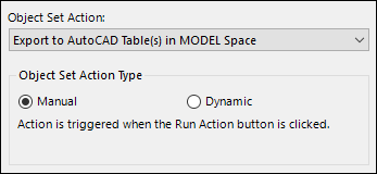

Object set action type
There are two different ways in which an Object Set Action can be triggered:
Type Description
Manual In this case, actions are triggered manually when the Run Action or Run Actions button is clicked This is the default behavior and is available for all types of Object Set Action.
Dynamic In this case, actions are triggered dynamically when any associated object is modified in the Civil 3D or Project Explorer windows. This action type is currently only Object Set Actions which generate AutoCAD Tables.
Note: The Project Explorer window must be open for the Dynamic Action Type to successfully detect changes to objects which are associated with a related Object Set.
Where the Project Explorer window is not open, any dynamic actions will be triggered when the Project Explorer is next opened. If you are unsure whether a dynamic action has been successfully triggered since a change was made to your design, the Run Action Run All Actions button may be clicked at any time to manually trigger the action.

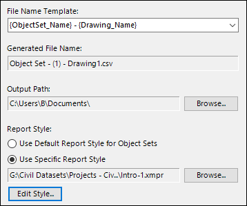

File output related options
The file name for the report or spreadsheet file can either be typed in, generated from a list of standard variables, or can be created using a combination of the two methods. The drop-down list of variables allows all or part of the filename to be generated from a list of variables such as the selected object name, object set name, the current drawing name, the current date, user name, computer name, and AutoCAD or Project Explorer version.
When using the Generate Report action, an output path must be specified to define where the generated report file should be created.
When variables or combinations of variables are typed into the File Name Template field, the resulting file name is previewed in the field directly beneath it.
A report style is required to define the page size, page orientation, page margins, report header, page header and page footer settings for the generated report or spreadsheet. Click the Browse button to select a previously created Report Style from a file to apply to the generated report or spreadsheet. Alternatively, click the Edit Style button to edit or define a style to use.

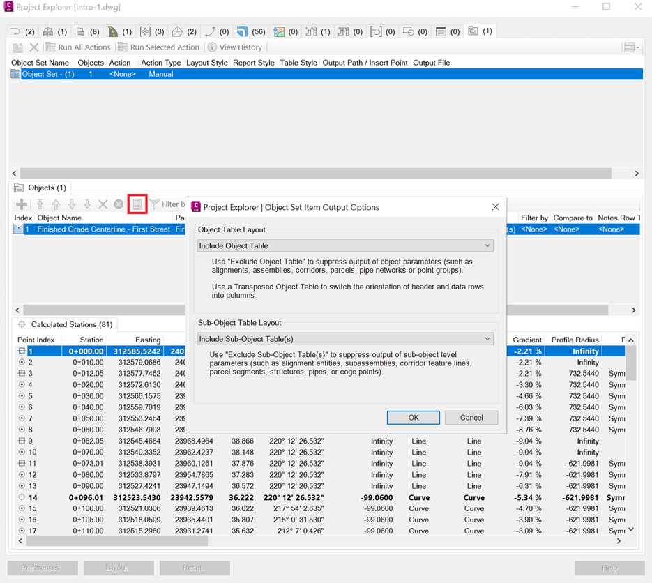

Suppressing the object table or Sub-Object table
For each item in an Object Set, at least two tables will be written to a table, report, or spreadsheet by default:
  • The Object Table - this is the table which includes parameters of the object, such as an alignment, corridor, parcel, or pipe network.
  • The Sub-object Table - this is the table which includes parameters at sub-object level, such as alignment stations or entities, corridor feature lines and points, parcel segments, or pipe network structures and pipes.
With the Exclude Object Table / Exclude Sub-Object Table options you can decide to suppress the creation of either the Object Table or Sub-Object Table. This is useful for situations where you might want to (for instance) create a report or table which includes a list of structures (which would appear in a Sub-object Table), but you do not need to see details of the pipe network (which would appear in the Object Table).

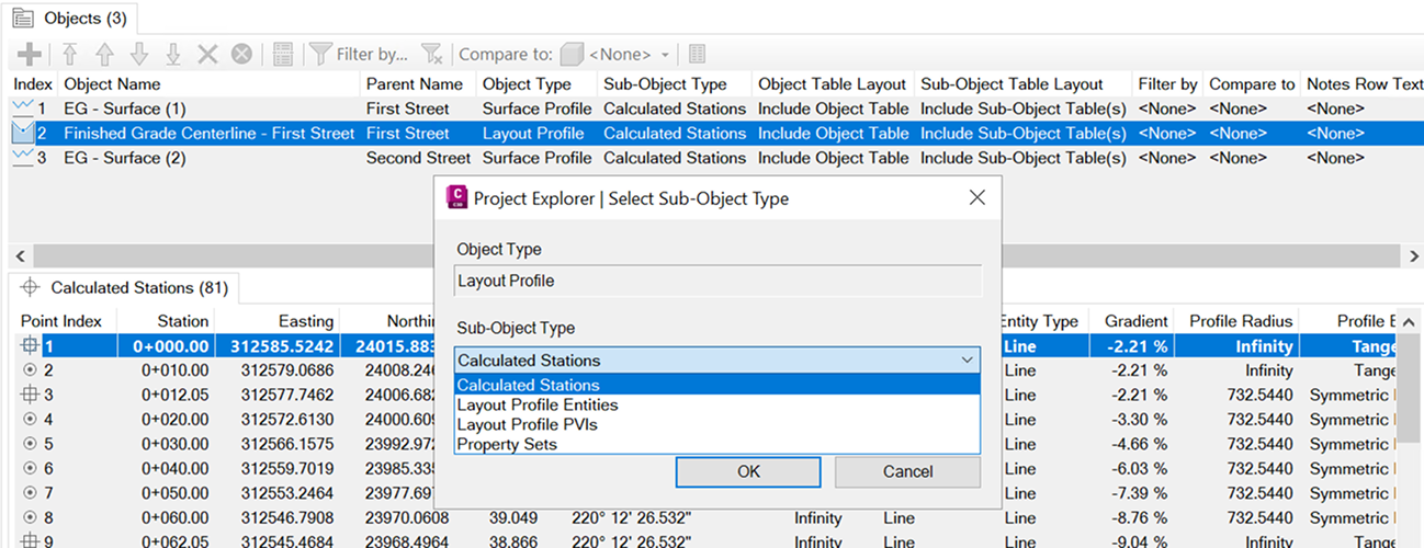

Changing the Sub-Object type
For some Civil 3D object types, there is a choice of available sub-object types for a listed Object Set Item. For example, for alignments it is possible to generate a report which includes calculated stations, alignment entities, alignment PIs, or superelevation critical stations.
For supported object types, the sub-object type can be changed after an object has been added to an Object Set. To change a sub-object type, simply double-click any editable sub-object type and select one of the available items from the list.
