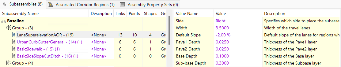

Editing individual values
Any value displayed in the Project Explorer window with a highlighted text color and a white background color is an editable value. Simply double-click any value to apply a direct edit. Changes are reflected in the Project Explorer window and in the AutoCAD viewport.

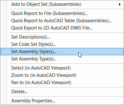

Editing multiple values
Selected parameters can be edited for multiple objects in a single operation in Project Explorer. To apply edits to multiple objects from the Project Explorer window, select several objects and choose an editing function from the associated right-click menu.

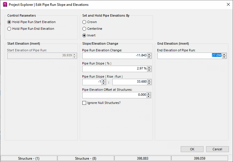

Edit Pipe Run tool
The Edit Pipe Run tool can be accessed from a button on the Pipe Network (Pipe Run) View toolbar. This tool allows a new constant pipe slope to be assigned to any pipes currently displayed on the Pipe Run View. Any changes applied are reflected in the AutoCAD viewport and the Project Explorer window.
A new pipe slope value can be applied while holding the elevation of the start or end of the selected pipe run, and if there are any changes to the diameter of pipes in the current run you can elect to hold the invert, crown, or centerline elevations of pipes when crossing each structure. Pipe slope can be expressed in percent or run:rise, and an elevation offset can optionally be applied when crossing each structure in the pipe run.

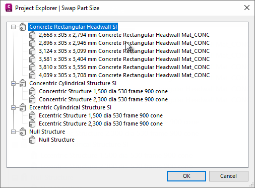

Multiple Part Swap Tool
To modify the part size of multiple structures or pipes, select the Pipe Networks tab in the Project Explorer window and ensure that the structures or pipes sub-object tab is active. Select the structures or pipes that you would like to assign the new part size to, then select Swap Parts from the right-click menu. Any changes are reflected instantly in the AutoCAD viewport and the Project Explorer window.
