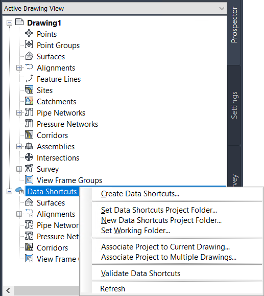

  1. In Toolspace, on the Prospector tab, right-click the Data Shortcuts node Set Working Folder.
  2. In the Set Working Folder dialog box, navigate to the project folder location in Autodesk Docs.
    The working folder for data shortcut projects needs to be at least one folder level below the Autodesk Docs project folder. For example, <Autodesk Docs Drive>\<Account Name>\<Project Name>\<Working Folder Name>. It is not permitted to set the working folder to a folder outside the project.
    Note: It is possible to set the top level \Project Files folder as the working folder, but only administrators can see the \Project Files folder so it is recommended that you use a subfolder within \Project Files.
  3. Click Select Folder.
    The Data Shortcuts node in Prospector changes to to indicate that the working folder is in Autodesk Docs.
  4. Right-click the Data Shortcuts node New Data Shortcuts Project Folder.
    • You can use the same name as the Autodesk Docs project or a different name.
    • If you already have your project folder structure set up the way you want it based on copying your template project, do not select the Use Project Template check box.
  5. Specify the name and the other project details, and click OK.
  6. Right-click the Data Shortcuts node Set Data Shortcuts Project Folder.
  7. Select the data shortcut project to use and click OK.
  8. In Autodesk Docs, verify that the new _Shortcuts folder that was automatically created when you created the data shortcut project has the required permissions.
  9. Create drawings and data shortcuts in the project as you normally would, and save them all in Autodesk Docs.
