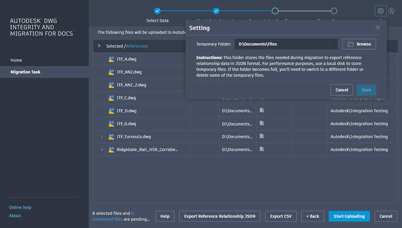

  • Added the ability to configure the location for temporary files generated during the creation of the Reference Relationship JSON.
