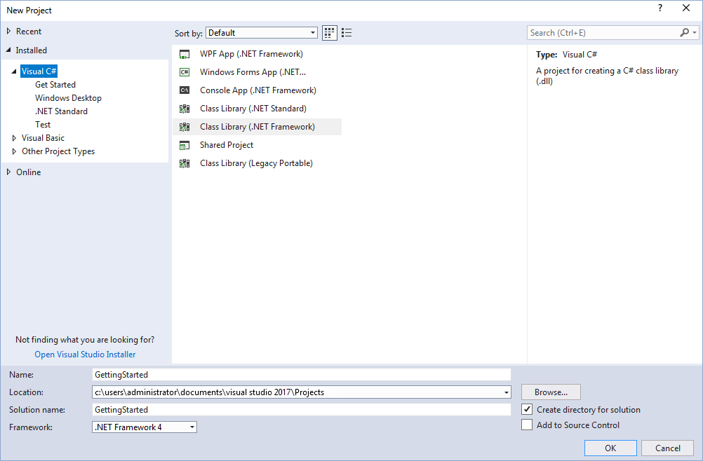

To create a new project that uses the Autodesk Civil 3D managed classes in Microsoft Visual Studio
  1. In Visual Studio 2010, create a new class library solution and project.
    New Project Dialog in Visual Studio

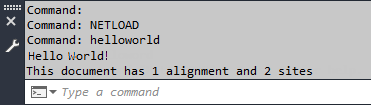

    You can now build the assembly and run it. Start Autodesk Civil 3D, and type NETLOAD at the command line. In the Choose .NET Assembly dialog, browse to your assembly DLL (if you are using the project settings from step 1, this will be GettingStarted.dll). Type HELLOWORLD at the command line, and you will see the command output:

    Open or create a document in Autodesk Civil 3D that contains alignments and sites. When you run the HELLOWORLD command now, you should see output similar to this:
