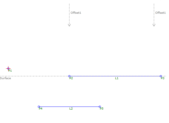

Examples
To see examples of how this geometry element is used, open the following Sample PKT file:
Surface Link Example.pkt
The example PKT contains two Surface Link examples. Each Surface Link is defined by a target surface and offsets. In the Flowchart, each example is constructed in a separate sequence. To review the parameters, select the surface link in the Flowchart, and then check the Geometry Properties section of the Properties panel.
There are two examples in the PKT file.
  • In the Offset Targets link, L1 is drawn between the two offset targets. Notice that while an End Offset value is specified, the value is overridden by the specified End Offset Target.
  • In the Static Offset Values link, L2 is drawn from the Start X value to the End X value. It is drawn at a Depth of 1, relative to the Target Surface.
