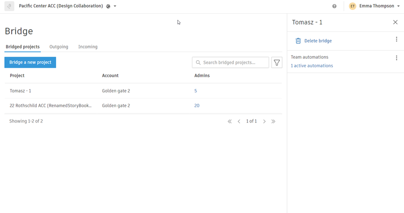

Bridged Projects tab
The Bridged projects tab shows the projects that this project has been bridged with, and is also where you can create bridges with other projects.
Creating a bridge to another project allows you to easily manage team automations to those projects. If you delete the bridge, all automations to and from that project will also be deleted. Both projects will retain any information previously sent through the bridge.

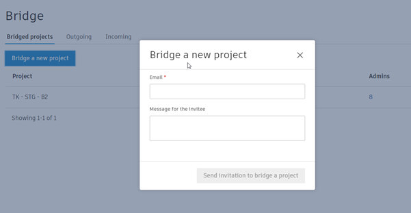

Bridge a New Project
To create a bridge with a project:
  1. On the Bridged Projects tab, click the Bridge a new project button.
  2. In the Bridge a new project dialog box, enter the email address of the invitee and optionally add a message describing your invitation.
  3. Click the Send invitation to bridge a project button to send the invitation.
    An invitation will be sent to the invitee and the project will show as 'Pending' in the Bridged Projects tab.
  4. If you've already created bridges with projects, click a project row to view details of the team automations and their status, or to delete the bridge.

Delete a Bridge
To delete a bridge:
  1. On the Bridged Projects tab, click a project row.
  2. In the details panel that opens on the right, click Delete bridge.
The connection between the two projects is deleted, along with any associated team automations.
Note: Any teams that had automations set up for that bridged project, and any packages shared by those teams, will remain visible and accessible in the External section of the Project timeline in the bridged project, even after the bridge has been deleted.
