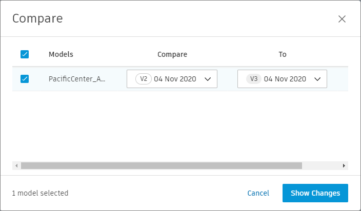

  2. Click the Compare button at the top-right of the page to open the Compare dialog:
    Note: If there are no changes or there is only one version of the selected model or document, the Compare button is grayed out.
  3. Use the dialog to select which models or documents you want to compare.
  4. Use the drop-down lists to select which versions of the model or document you want to compare.
  5. Click Show changes.
