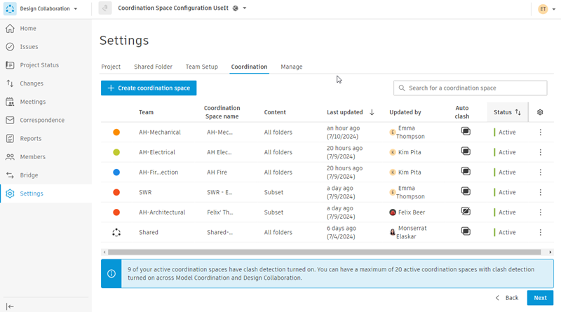

  1. Click the Settings tool > Coordination tab.

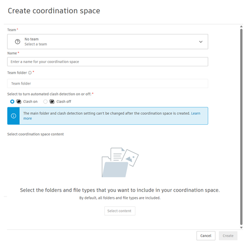

  2. Click Create coordination space.
  3. Select the team that you want to create this coordination space for. You can also select the Shared folder.
    Important: The Team folder field displays the root folder path for the coordination space based on your team selection. The root folder can't be changed later.
  4. Enter a name for the coordination space.
    The team name is used as the coordination space name by default, but you can rename the space without changing the team folder name.

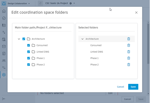

  5. Select the content that you would like to include in the coordination space. Choose from:
    • Main folder and all subfolders - Includes all content in the folders as defined by the selected team.
    • Selected folders only - Use the Edit coordination space folders dialog to select or deselect folders as required, then click Save.
    Note: This content selection is independent of selecting the included content folders for your team space on the Team Setup tab. It can also be changed later.

  6. Specify whether you want automatic clash detection turned on or off.
    Important: This setting can't be changed later.
  7. Click Save.
  2. Click the more menu in the row corresponding to the coordination space that you want to edit.

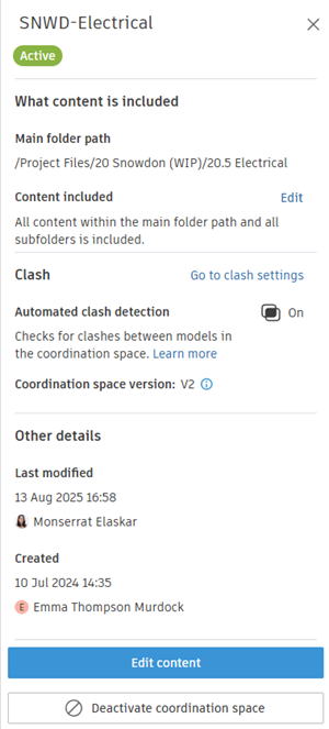

  4. Click View details to open the coordination space details panel.
    Here you can see what content is included, the clash settings, and details such as when the coordination space was created and last modified. You can also access options to edit the included folders and deactivate the coordination space (see steps 5 and 6).
  5. Click Edit folders to open the Edit coordination space folders dialog. Select or deselect folders to specify the content you want to include in the coordination space, and then click Save.
    Tip: This is useful if you have only specific models that you want to aggregate or clash in Model Coordination. Generating excess clash data can impact product performance. See Clash FAQ for more information.
  6. Click Deactivate to deactivate the coordination space.
    Note: Deactivated coordination spaces are not deleted, and can be reactivated at any time by selecting the Activate option from the more menu.

  3. Click View details to open the coordination space details panel.

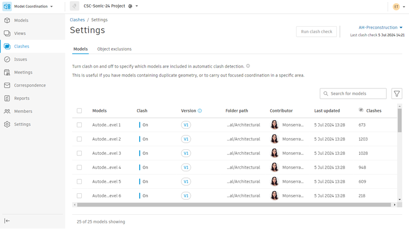

  4. Click Go to clash settings to open the Clashes tool > Settings page > Models tab in Model Coordination. Your coordination space will be preselected, and the models will be listed.
  5. Use the Models tab to turn clash detection on or off for selected models.
  6. Use the Object exclusions tab to exclude specific model objects from clash detection.
