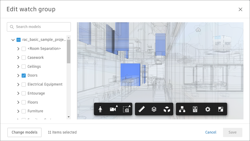

    1. Click Edit to change the models or items included in the watch group:
      1. Click Change models and use the dialog box to add or remove models.
      2. Click Next.
      3. Use the Edit watch group items dialog box to change the selection of items included in the watch group.
      4. Click Save, or click Cancel to discard your changes.
