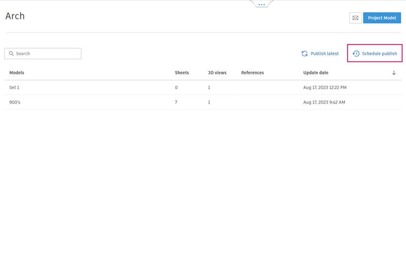

  2. Click Schedule publish or, if a schedule already exists for your team, click the schedule instead.

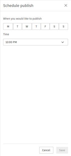

  3. On the Schedule publish panel, click the day on which the publish should occur.
    Note: Currently, only weekly publishing is supported.
  4. Use the Time drop-down list to select the hour of day in which the publish should occur.
    Note: Publishing is attempted within the hour selected, and can take an hour or longer to complete. Therefore the time you select represents the earliest possible time that any file changes will be picked up.
  5. Click Save to save the schedule publish settings.

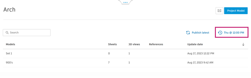

  3. If you are using the Home tool:
    1. Select your team from the timeline.
    2. Click the existing schedule, which is displayed at the right of the screen:
  1. On the Schedule publish panel, deselect the day on which publish currently occurs.
  2. Click Save to save your changes.
