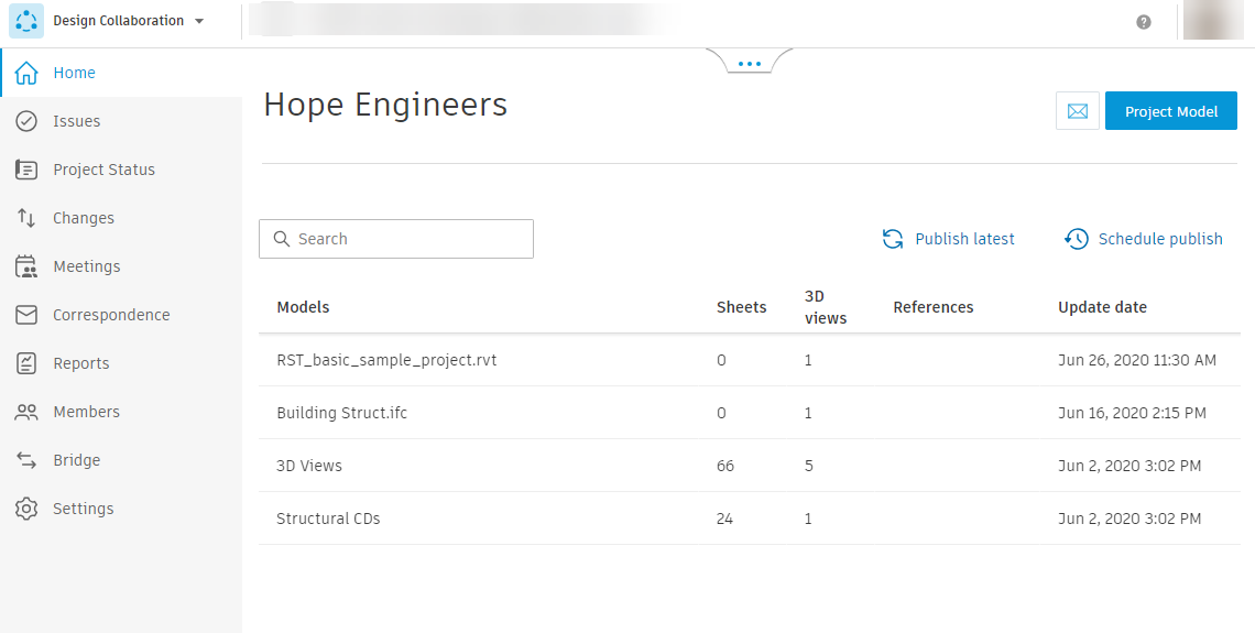

The Home tool contains the Team Space, which is the main portal for your team in Design Collaboration. It provides an up-to-date viewing experience of the current state of your models. When you first enter the Home tool, you see a list of the latest models, sheets, and 3D views that your team has published as sets from Revit.
From the Home tool, you can:
- Access the timeline.
- Create packages.
- Turn email notifications on or off.
- Access the project model.
- Publish the latest data to your Team Space, and schedule regular publishing of your models.
