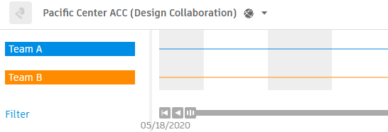

We see the two teams on the project timeline in Design Collaboration:

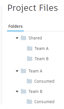

We also see new shared and consumed folders for the two teams in the Files tool in Docs:
All of these folders are created when you add teams using the Settings tool for Design Collaboration. The shared folder and its subfolders for each team represent the shared space for all teams. The consumed folder and its parent team folder represent the Team Space for each individual team.
