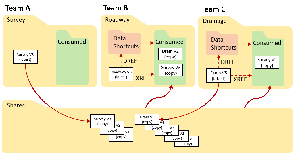

Controlled Sharing - Low Trust Environment
Using this workflow, teams have no access to each others work-in-progress models, which are stored in the respective team folders. Each team can share packages containing their models when ready, and other teams can choose to consume them. XREFs can then be used to link to these consumed models in their own Consumed folder.
Each team uses an independent Data Shortcut working folder, and DREFs can be used to link to other teams' Civil objects from consumed packages. Teams can also control which version they consume.

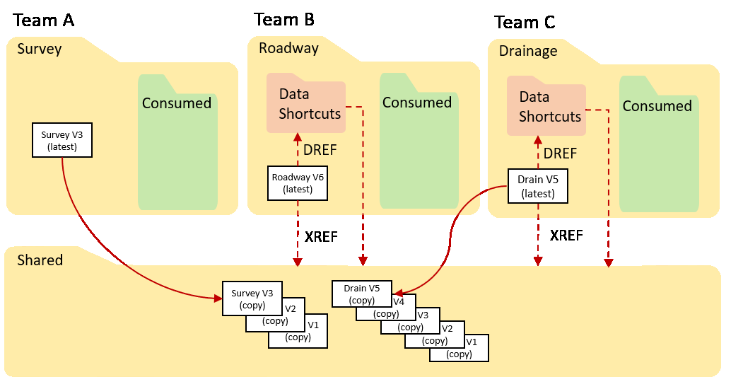

Controlled Sharing - Medium Trust Environment
Using this workflow, teams have no access to each others work-in-progress models, which are stored in the respective team folders. Each team can share packages containing their models when ready. XREFs can then be used to link to other teams models directly in the Shared folder.
Each team uses an independent Data Shortcut working folder, and DREFs can be used to link to other teams' Civil objects in the Shared folder.
