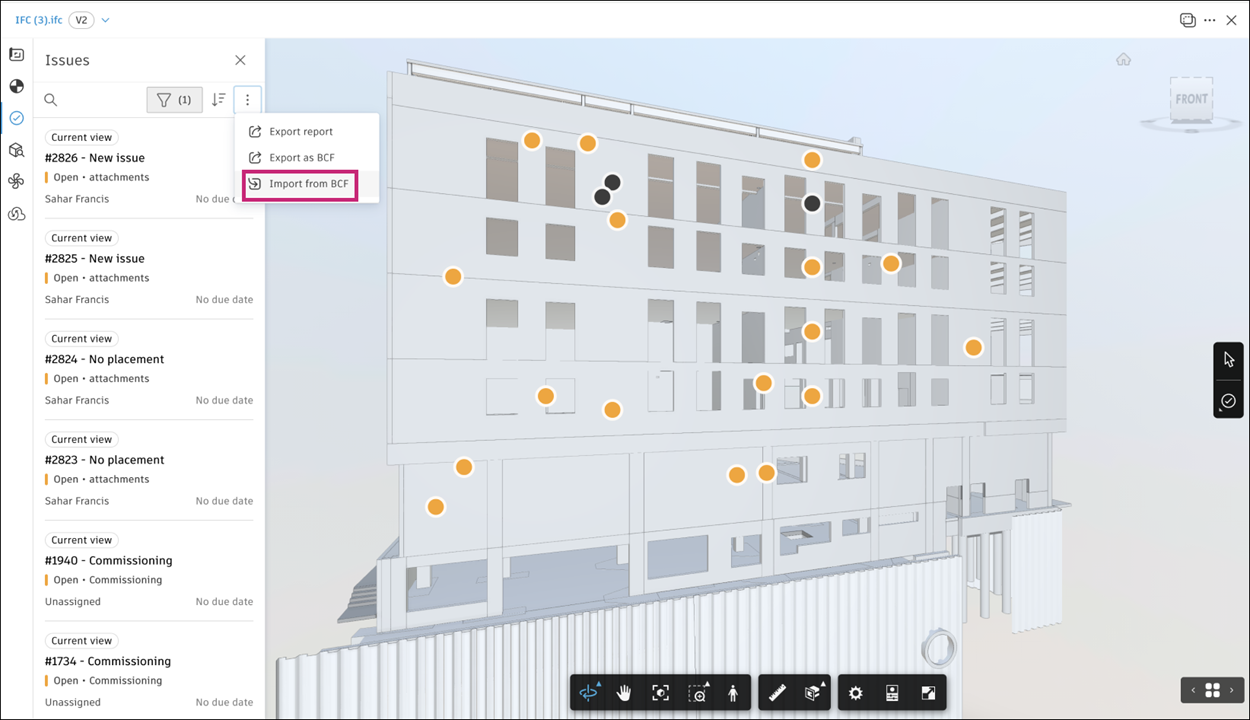

  1. Click in the left navigation to open the Issues list view.
  2. Click the More menu at the top right of the Issues list and click Import from BCF.

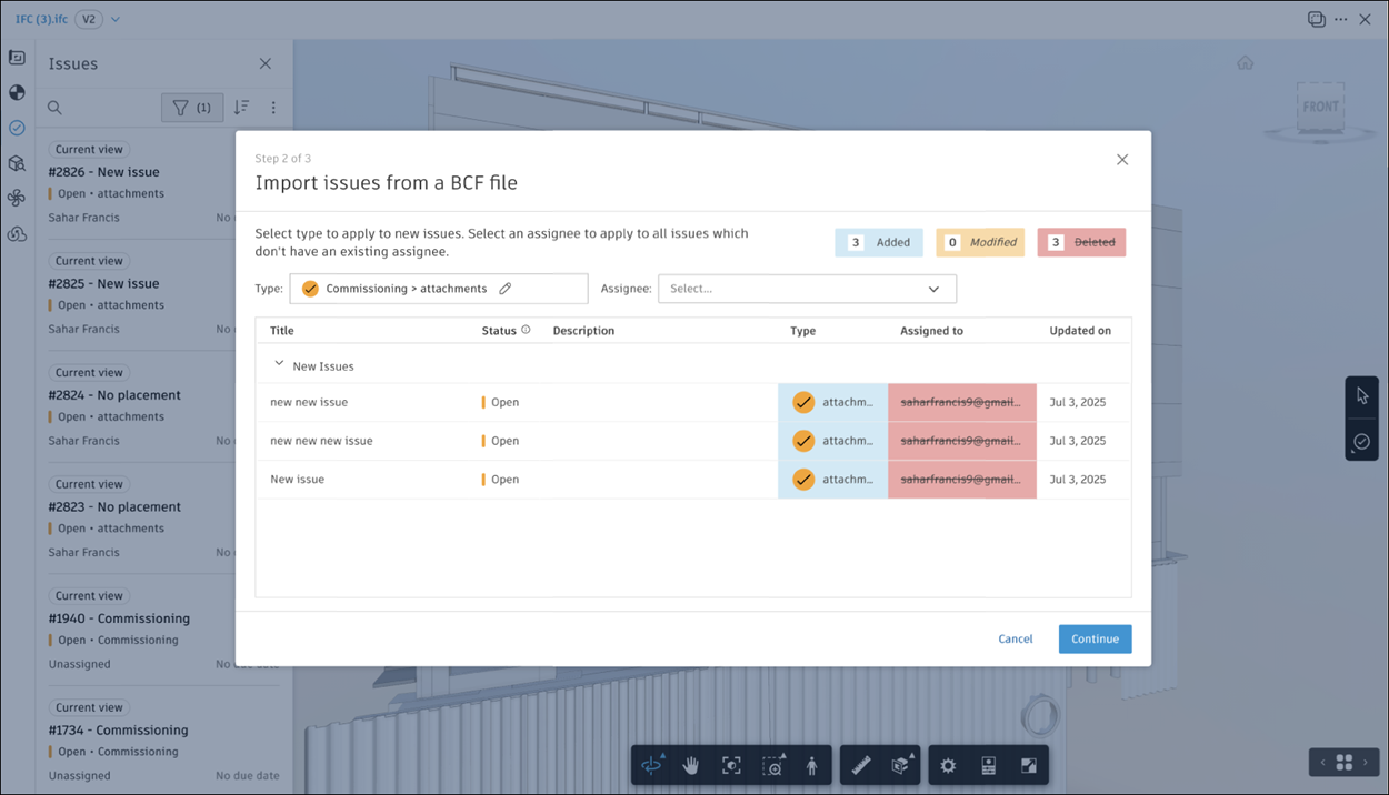

  6. On screen Step 2 of 3, use the Type drop-down list at the top left corner of the screen to assign a desired default type to new or updated issues.
    Note: On import, the status of all issues except closed ones defaults to Open.
  7. Use the Assignee drop-down list at the top left of the screen to assign a relevant member, role, or a company as a default assignee to new or updated issues.
  8. Click Continue to proceed.
  9. On screen Step 3 of 3, review the details of the issues that you're about to import.
    Tip: You can use the in-line drop-down list to edit assignee as needed.

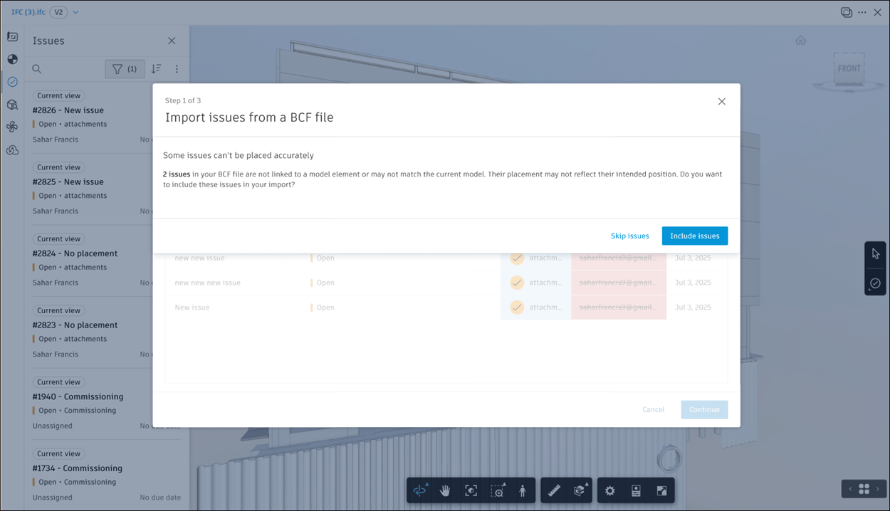

When you import BCF issues into the Issues tool, some issues may not include a selected element. ACC requires each issue to be placed on a specific element in the model. If such issues are imported, you will be prompted to either import or skip them, as described below.
  1. In the viewer, click in the left navigation to open the Issues list view.
  3. If the BCF file contains issues without a selected element, you will see the following message:
    Click Include issues if you want to import issues without a selected element or click Skip issues to skip the import of such issues.
  4. Select the type to apply to the issues without a selected issues element from the Type drop-down list at the top left corner of the screen. Select an assignee from the Assignee drop-down list in the upper right of the screen.
  5. Click Continue to proceed.

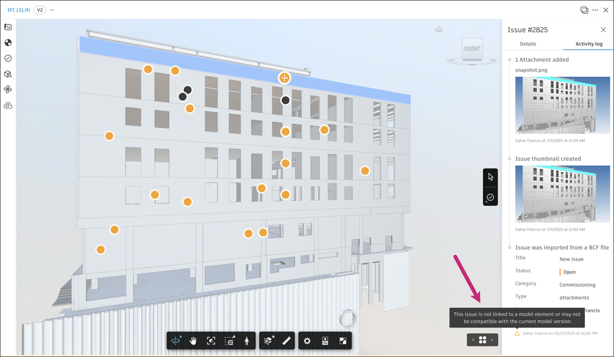

Tip: Issues without a selected element have the following indication in the Activity log tab of the issue panel.

  • If no selected element is present:
    • ACC places the issue at the center of the camera’s viewpoint, based on the camera position and direction.
    • The pushpin appears in the model viewer when you select the issue.
    • The pushpin is not attached to a specific model element.
    • The issue’s location matches the BCF thumbnail viewpoint as closely as possible.
