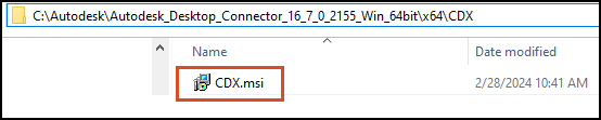

Installing Desktop Connector using MSI vs. EXE
What are MSI and EXE files?
A MSI (Microsoft Installer) file and an EXE (executable) file are both types of installation files.
- The main difference between them lies in their customization and deployment capabilities.
MSIfiles are database files, used by Windows Installer, that store installation settings for software applications. They allow for more customization and are used for network-wide software deployment. - On the other hand,
EXEfiles are standalone executable files that initiate an installer for a software program. They are simpler and less customizable.
Desktop Connector Installation Files
The recommended method for installing the Desktop Connector is by running the downloaded .exe file located in the Downloads folder for the current user. When you download the desktop connector .exe it will be found at the following location:
C:\Users\<username>\Downloads
You will have to run the
DesktopConnector-x64.exeand allow it to self-extract to the default location:C:\Autodesk. By allowing it to self-extract you may find the CDX.msi at the following location on your hard drive:
FAQs for using MSI vs. EXE installs
Can I use the .msi file for installation?
Yes, you can use the .msi file for installation, but it does not bundle any dependencies. You will need to install these separately.
What happens if I use the .exe for installation and the .msi for upgrade (or vice versa)?
Using different methods for installation and upgrade might result in dual entries in the Programs list. It's best to use the same method for both.
What are the dependencies that I need to install if I choose the .msi file?
The dependencies include but are not limited to Identity Manager/ADSSO, .Net runtime, and C++ runtimes.
Where can I find information about changes in dependencies if I decide to handle them myself?
Remember, these practices and FAQs are based on feedback and customer testing and might not cover all possible scenarios or questions. For the most accurate and comprehensive information, always refer to the official Autodesk support and documentation.
