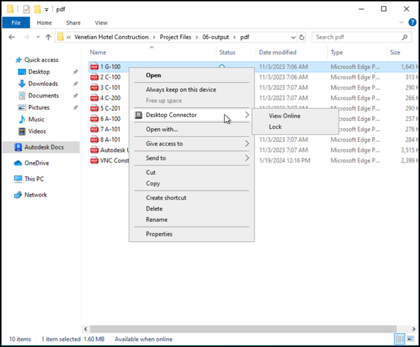

Desktop Connector Right-Click Commands
When Desktop Connector 16.10.x and above is installed, the following commands will be available in the right-click menu.
  • View Online - navigates to a file's location directly in Autodesk Docs web.
  • Lock/Unlock - manually lock or unlock a selected file. Learn more about File Locking.
  • Create Viewable - from v16.15, manually generate a viewable for selected files. You can then check the file's status in Autodesk Docs web using View Online.
Note:
The Desktop Connector Right-Click commands will not be shown if Desktop Connector is running elevated as this is not supported. Learn more about Unsupported Workflows
Right click on a file and choose Lock/Unlock from the Desktop Connector menu. (Shown in Windows 10)

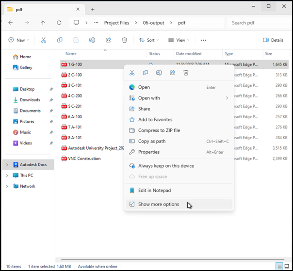

To access the Desktop Connector Menu in Windows 11, you will need to first choose "Show more options." Alternatively, you can hold the Shift key and right-click to get the full context menu in Explorer without having to click "Show more options."

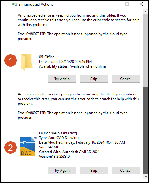

Moving Files and Folders between Projects
Important: Starting in version 16.1 Desktop Connector will not allow files/folders to be moved from one project to another. When a move across projects is attempted a dialog will be seen that states "An unexpected error is keeping you from copying the file.". However as an alternate solution files/folders can be copied between projects.
  • Moving files and folders between projects is unsupported. If you try to move a file or folder you will receive the following error indicating that you cannot perform a move between projects.
    1. Moving a folder
    2. Moving a file

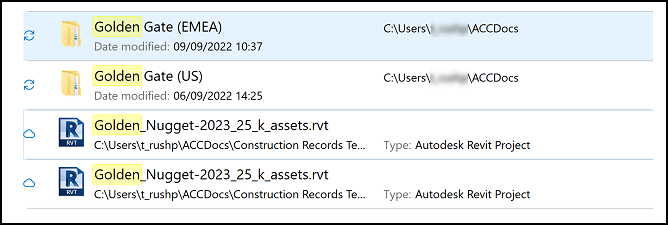

You can use keywords to search across all projects or in specific projects or folders.
  1. Select:
    • The Autodesk Docs connector to search all projects
    • A specific project to limit your search to that project's folders.
    • A specific folder to refine your search to that parent folder and all subfolders.
  2. Click the search box in the top right of File Explorer.
    Search Box
  3. Enter your keyword and press enter.
    Explorer View
Your search results will display with the keyword highlighted in the files, folder, project, or path where relevant.
