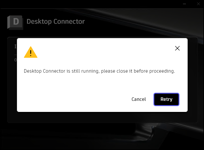

Install Stopped
If you tried to install Desktop Connector and received a warning that Desktop Connector is still running, follow these steps:
Installer Extract
  • Cancel the install.
  • Exit Desktop Connector by selecting the tray icon DC Tray Icon, right-click, and exit the program.
  • Once you Exit, rerun the Desktop Connector installer.

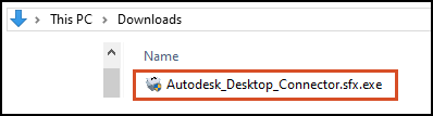

  1. Download Desktop Connector as detailed previously in Download Installation Files.
  2. Double-click the .exe file to install/upgrade Desktop Connector.
    DC Downloaded File

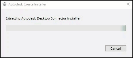

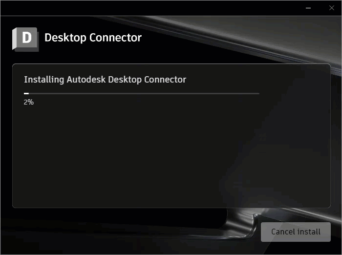

  3. The installer will unpack and prepare your files for installation.
    DC Prep Installation

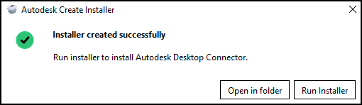

  4. Once your download is complete you will be presented with a dialog to Open in Folder or Run Installer.
    • Open in Folder: This will open up the folder in File Explorer DC File Explorer Icon where the install files are located.
    • Run Installer: Starts the install of Desktop Connector.
    DC Installer Created

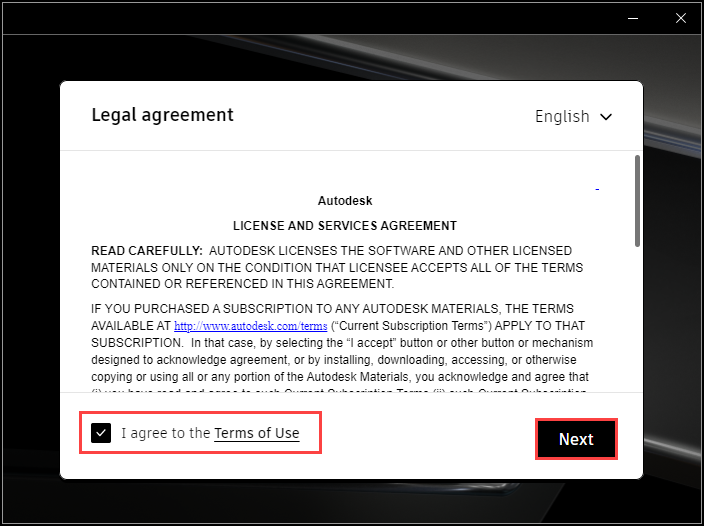

  5. Read and check I agree to Terms of Use and select Next.
    Terms and Conditions

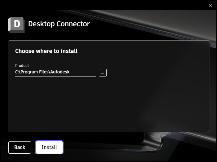

  6. You can use the default program file location: C:\Program Files\Autodesk\Desktop Connector or change the location.
    Note: Changing the location during an install update (installing newer version over an already installed one) will lose the setting of whether Desktop Connector was in online or offline mode. If new files are added to the workspace while Desktop Connector is in offline mode and before going online, the location of the install is changed through an upgrade install.
    • Best practice is to go offline and then back online to confirm that those files are uploaded to the data source.
    Important: Changing this location will not change the location of where the Desktop Connector workspace is stored.
    Install Location

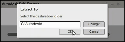

  2. Double-click the downloaded .exe file and allow it to extract.
    Installer Extract
  3. Read and check I agree to Terms of Use and select Next.
