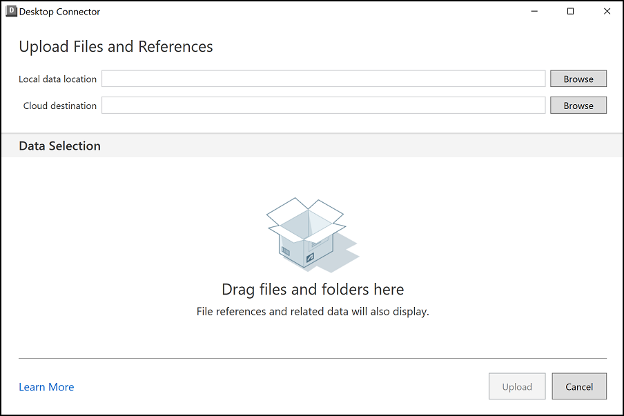

The Upload Files and References Tool enables you to add design files and view all their gathered references and related data before uploading all listed files to the cloud.
Add Design Files
  1. Right-click the Desktop Connector tray icon Desktop Connector Tray Icon.
  2. Click Upload Files and References in the menu.
    Upload files and references
    You can add files in the following ways:
    • An individual folder.
    • Multiple Folders.
    • A combination of files and folders.
    • A single file.
    • Multiple files: You can only add multiple from the same parent folder.
    Note: You can't add design files which are already in the Forma connector.
  3. Add your design files:
    • Drag and drop files and folders.
    • Click Browse next to Local data location: Browse to select single or multiple files. The location of a single file will display or it will display as various for different file locations.

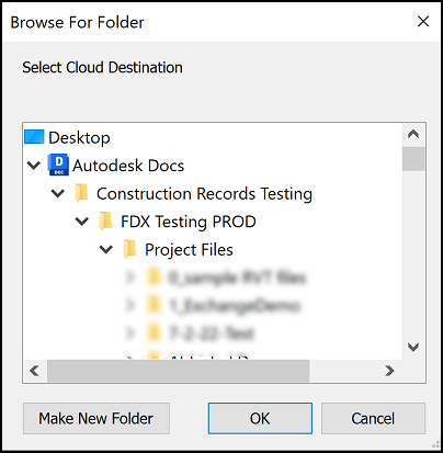

  1. Click Browse next to Cloud destination.
    Cloud Destination Location
  2. Select a target folder in your Forma connector
  3. Click OK
  4. Click Upload
  5. You can view the upload progress in the home screen
Desktop Connector will attempt to recreate the folder structure of the host file and references within the folder selected in Cloud destination.
If references are found outside the design file root folder or its subfolders, these references will be uploaded into a new folder called Related Data.
